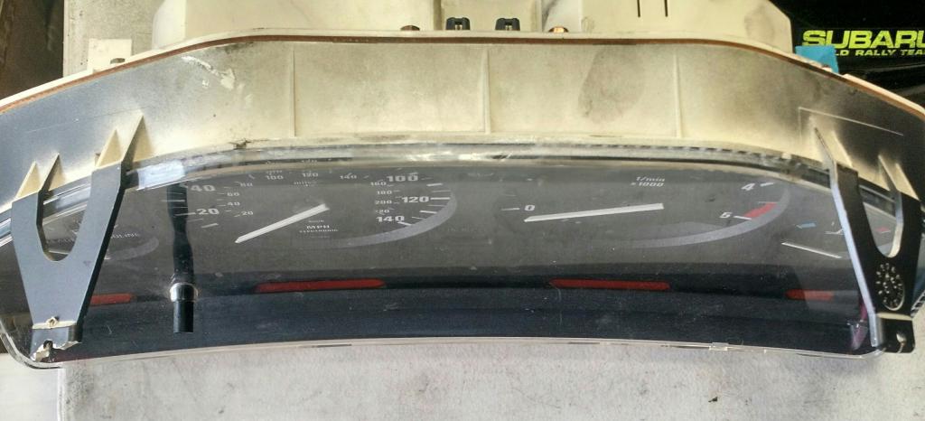

          PO took out the cluster and put an new one in. The cluster I'm replacing the gears on has milage closer to that of the car, but the tabs are broke. Suggestions?

            Also says "Motometer" on it, so I figure it's a motometer lol

              Try putting it in like that. The cluster should be, for the most part, snug even without them.
              • Kershaw
                • 11822
                That's not broken enough to be a problem. It'll still install fine. If you want, you could put a washer around the screw that holds the more broken tab and maybe glue the crack on the other side so it doesn't break more.
                if you REALLY wanted to go all out, you could get some epoxy clay and build out the tab a little and reform the hole (before the clay sets, it'll be easier.)
