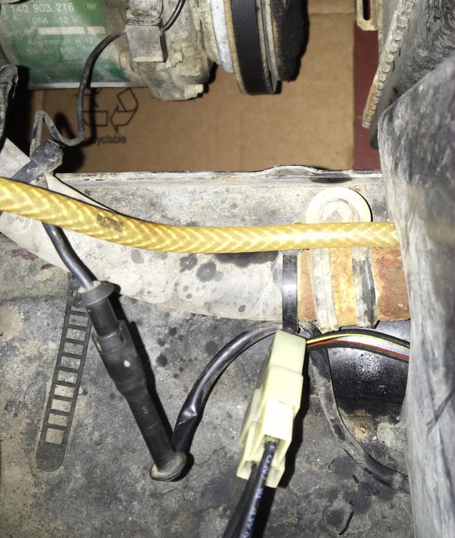

                        Originally posted by e30rapidic
                        run a 12V power supply directly to the compressor. You should hear a loud click, engaging the clutch. That will take out the guesswork of a compressor replacement at least.
                        I just did this and it was surprisingly easy; the positive wire going to the compressor has a connector right next to the low-pressure switch connector (not sure if it's the same on newer models):
                        I ran a 3' jumper wire between it and the positive terminal on the left side of the firewall and heard a reassuring click as the clutch engaged.
