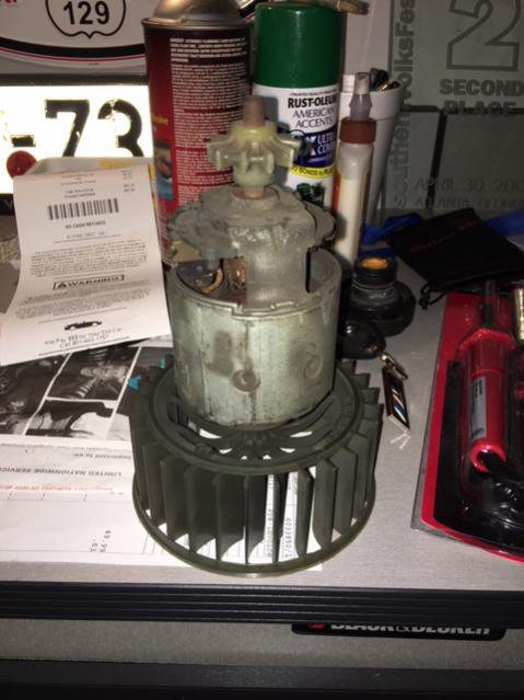

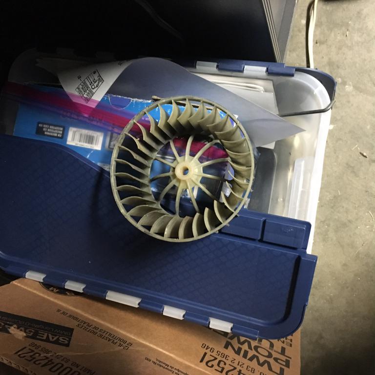

            Just a quick update, I finally scored a used blower motor from a '90 325i at the local pull a part. It was a good practice to take it out so I was a little prepared. That metal clip is a biotch and a half to unclip, clip it back was really easy. Taking the motor in and out was tricky to say the least.
            So I have no idea what happened to the original blower but the PO was right, one of the impellers was totally missing, good thing it was not affecting the balance since it was still working (half force). Now I finally have a full blast air/heat!
            It was definitely the best route to replace the whole thing since I don't have the right tools to extract and press the wheel onto the shaft.
