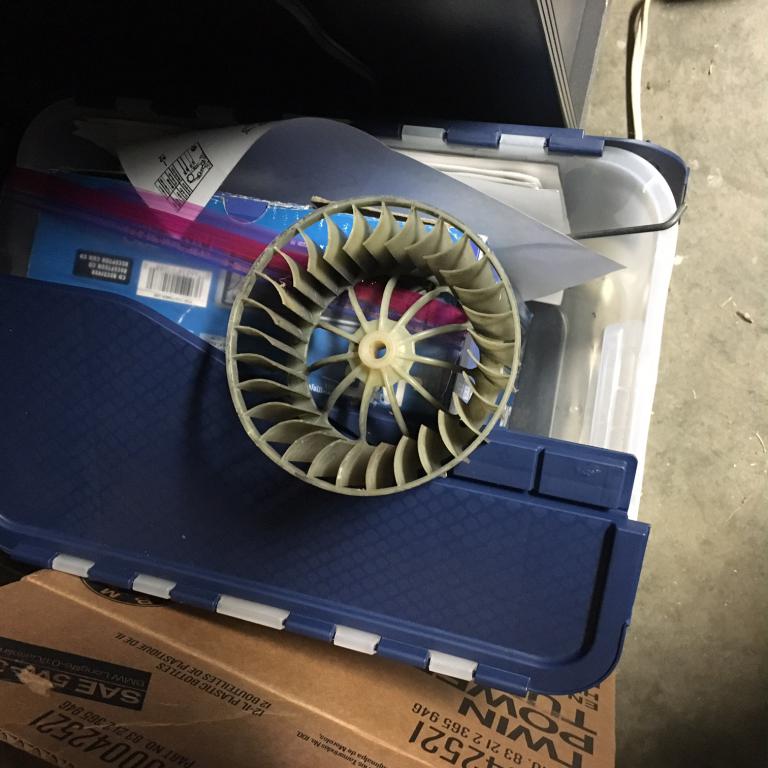

      Also, the blower motor has two fans, the fans are like a little hamster wheels, with little fins that break with time...Depending on how many are broken, the air flow volume will be diminished exponentially.
      I have the same issue, I'm having about maybe 60% of the "normal" flow, and the previous owner passed on an used fan wheel, but I'm reading that it is better to replace the whole thing (blower motor with two fans) since it will probably finish breaking in the process.
