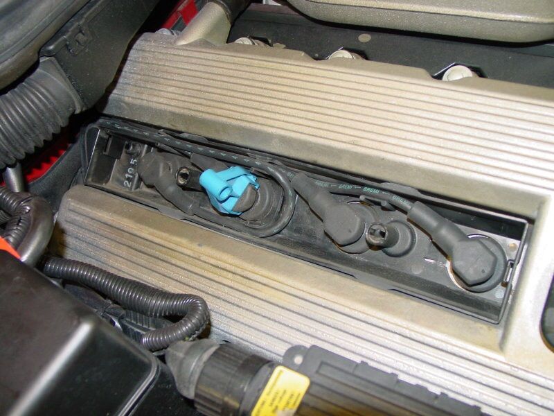

            • Balleristic31
              • Aug 2009
              • 4198
              In your second video it looks like the cylinder 3 and 4 wires might be switched. There should be enough extra wire on cylinder 4 to wrap around cylinder 3's wire.
              Like this:
