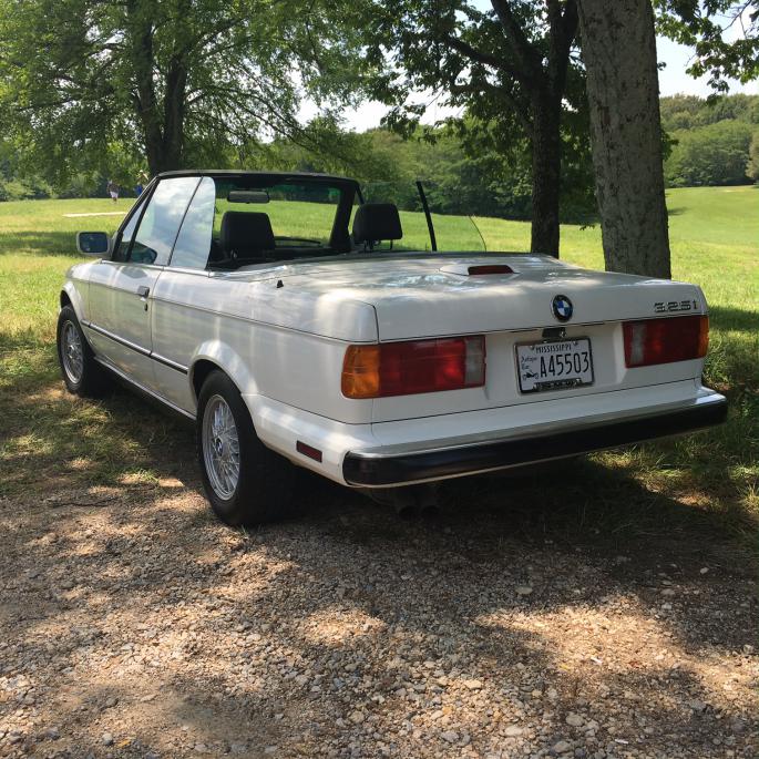

    Originally posted by berndt
    Nice. Here's my similar 92 that I picked up about 4 months ago. It's stock with 164k miles. Since I got it, I've done the following:
    * timing belt/water pump/plugs/rotor/etc.
    * reupholstered seats (leatherseats.com)
    * converted broken automatic top to manual
    * new(ish) top
    [ATTACH]110502[/ATTACH]
    Did you select 1991 model from LeatherSeats.com, since 1992 isn't an option?
    Once you ordered from LeatherSeats.com, what did it cost to install?
    Leave a comment:
  • berndt
    replied
    * new(ish) top
