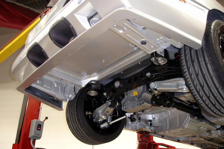

Name:	franken m3 rear.jpg
          And why not go this route instead of old e36 stuff if you're doing all that work??

              E46? Nawww, that'll tear out of the trunk!
              heh

                That is all e90 not e46 !
                • ForcedFirebird
                  • Feb 2007
                  • 8300
                  More info on the build, please? I have considered doing a multi-link e30 swap, but there's just something about the lift-slide effect the e30 trailing arms have and I love lol.
                    Well, see, that just proves we need more pictures...

                        Originally posted by MR E30 325is
                        Exactly, more pics or a link!
                        Here you go, it's the Franken-M3..... awesome machine!!
                          https://pipermotorsport.myshopify.co...ect-franken-m3
                          Read about this car so many times, and didn't even recognize the pics. :/
                          Epic build.
