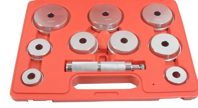

            The best way is to get a bearing/race driver kit. They're not expensive.
            Looks like this:
            I'd get aluminum if you have the choice.
              Looks like this:
              I second this advice. I was having a really hard time getting my diff seals in properly until I bought one of these sets. Went it fast and easy. It’s always worth it to have the right tools.

                Harbor freight sells an aluminum version of the kit shown above. Very cheap and can be used for all types of applications.
                I used mine for rear axle seals on my truck.

                  You could also rent a kit like that from an auto parts store.
                  • Kershaw
                    • 11822
                    That is the harbor freight aluminum bearing driver kit. I have it. I've used it for years and replaced at least a dozen front wheel bearings (ix) with it. Works great.
                      I go to autozone and rent the kit every time i need to do it
