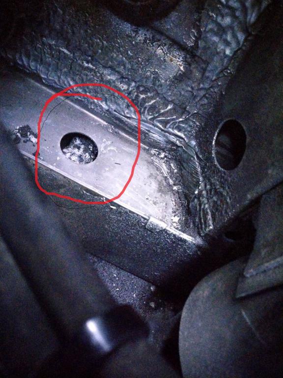

    i have lost brake pedal pressure a few times recently. and it comes back without notice.. plus i leak brake fluid which collects nicely in this trough.
    searching for the leak and cleaning i came to the conclusion the grommets were failing in the master.
    we switched them out. re bled the lines and resealed everything. i have pressure and stop perfectly.
    on the drive home i noticed more brake fluid in the trough.. (see pics)
    directly below the master is a trough with a hole that goes to the back of the car ... the fluid collects there and leaks out another square hole further back ... that trough in the chasis is about 3 feet long...
    do you think it still has fluid in it?
    does a puddle brake fluid slosh that much?
    i have dried the trough again and will take a look when i get home to see if its wet again...
    anyone deal with this before?
    hope it makes some sense....

    pics of holesClick image for larger version
ID:	7197452Click image for larger version

      thebtrough filled with brake fluid again.. it was dry when i left.
      help.. where else could the brake fluid possibly leak from?

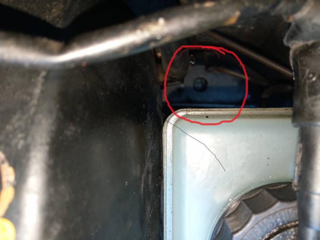

                  https://www.realoem.com/bmw/enUS/sho...diagId=34_0153
                  does anyone know what item #8 is in this pic??
                  i think the leak is coming from there... almost positive.
                  so what is it? can't find it anywhere...
                  please and thank you

                        the leak is coming from the bottom of that unidentified thing in previous post...
                        need a part number.

                          Intermediate piece. # 34321156869

                            • cheffy30
                              • Sep 2016
                              • 1159
                              that my friends is the brake pressure regulator. the little fucker.
