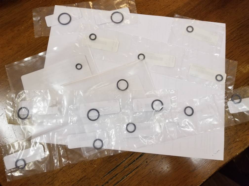

                        I bought an r134 seal kit off ECS, and the seals are all grey. Have you guys seen grey r134 seals, or do they have to be green? When I questioned them, ECS said these are r134 seals. It doesn't look like picture online.
                        https://www.ecstuning.com/b-genuine-...4508390605~kt/

                          From my experience grey is oil safe and green can handle the bigger pressures of 134a
