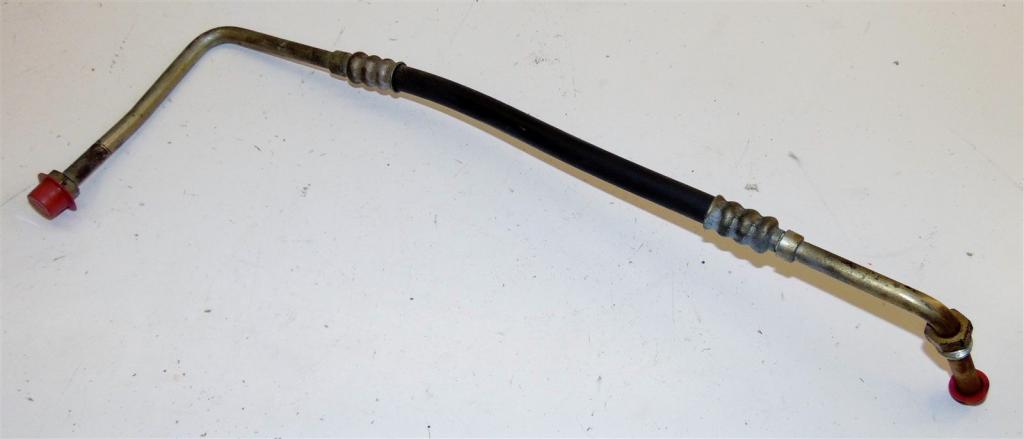

    Anyone made their own a/c hoses?
    I did a full R134a conversion on my 89 325i last summer including compressor, expansion valve, drier, switch and condenser. I replaced only one hose I believe on account of the others were over a hundred dollars each, only available as BMW authentic parts. The system leaks out over a week or so and the dye/sniffer didn't help. I'll be pulling the motor soon and this will be the time to replace more lines.
    Always game to tool up, I see very nice Mastercool crimpers being sold for the price of one of the three hoses I need to make. Has anyone gone this route?
    Can the hard portions or the lines be re-used, with the appropriate crimps?

    I cleaned out the metal hoses and took them too a local hydraulic hose shop and they replaced the rubber with barrier hose and crimped the ends for me. Cost me $85 and about 45 minutes of my time. I expected to drop them off and have to come back but they did it right then and there!

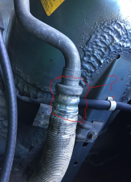

                              Could use someone's help figuring out what the name of the fitting is where a hose connects to a hard line.
                              A photo of the hard lines stripped of the hoses would help too. Are these barbed? Is this just a ferrule such as: https://coldhose.com/specialty-fitti...ividually.html
