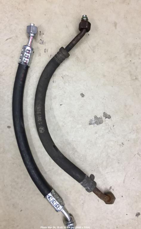

      The two hoses above the glove box were NLA last I looked. That's good to know, I didn't realize you could just have the hose upgraded to barrier.
      When I did mine only 1 was NLA but I got lucky and found a pair NIB on ebay & those are the ones I had upgraded. The other 3 hoses I bought in the normal course of things.
      While all this was going on I actually spoke to Aeroquip who is the OE mfg and they gave me the specs on barrier vs non barrier hoses. They are rated in grams/hour/foot (or some other measurement) of hose. I believe the difference based on r134 was about 9X and those 2 hoses were leaking over their entire length.

          I was in Charlotte at the time and I had to top up the system in the spring then another 2-3x through the summer. I would notice a drop in performance within a week or 2 of a recharge.

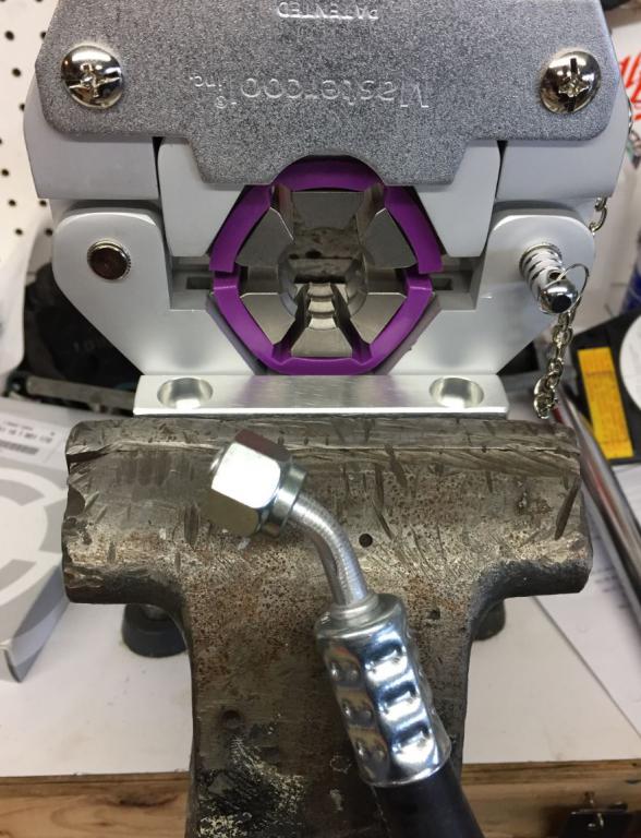

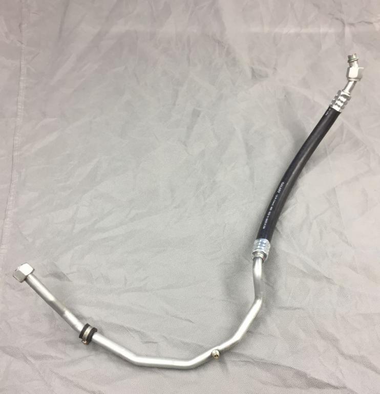

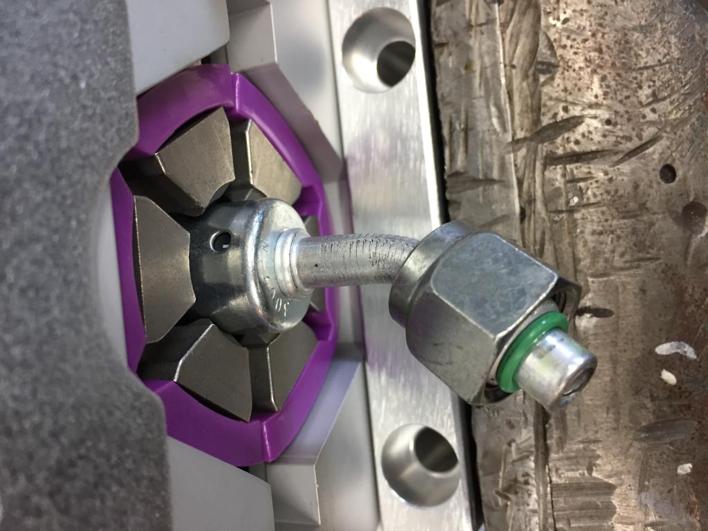

            As usual having the right tools makes all the difference. I might post a new thread with all the part numbers etc for anyone searching in the future.
