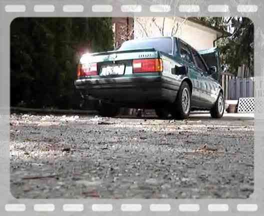

    Just ran some seafoam through my intake and gas. I noticed my engine runs smoother now. Here is a video clip i took of the smoke show
      nice vid....But not even 1/10 of the smoke you can get out of running a can into you intake mani.
      I've done this to 5 or 6 different motors/cars – so I guess I’m the “expert” on the subject. LOL
      The results are always the same when done right - smoother at idle, smoother at revving. The only chance you take is hyrdo-lock. Just add it slowly – say a tablespoon every 2 seconds. Or in other words a drop every rev at 1000rpms. Then go drive the piss out of the car.
      Best thing is to inject/stop and soak/inject/stop and soak/inject - then go rev it to high hell...
      Don’t add it to your oil. A good quality oil will do fine on it’s own.
      I did a “seafoam” treatment to my m30 (with bad plug wires) before I smoged it – and it made SO much freaking smoke – it smoked for 10 miles of HARD hard revving – going down the street it looked like I had a bale of hay on fire under my car
      The stuff gets deep into your cat, and blows out all sorts of nasty crap.
      BTW: I passed smog WAY below what even an m20 puts out…
      This is coming from someone that “hates” to use additives to fix a real problem. But it works.

          By the way, Crunk3, what type of exhaust do you have? The videoclip was pretty cool.
                  thanks, its a Magnaflow
