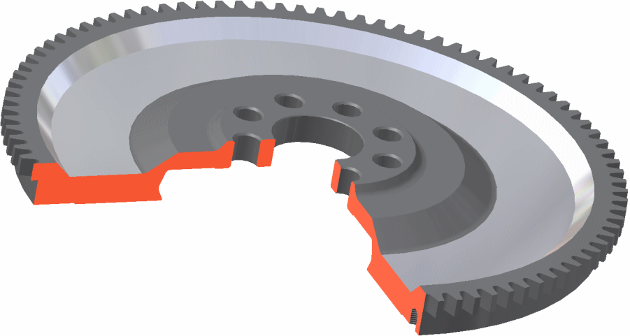

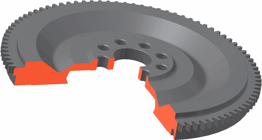

    This results in about 12.9lbs

      you need a step on the clutch surface. there is a spec for it, the bentley is wrong - any shop that can surface flywheels should have a book with BMW specs in it.
      to make it lighter, yes you can shave the back side. the big "rib" of material is basically just there for added weight.

            My flywheel is only shaved flat with the ring gear. I haven't seen images with it going below that point.
