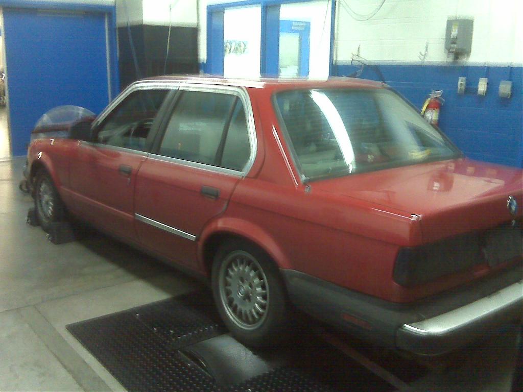

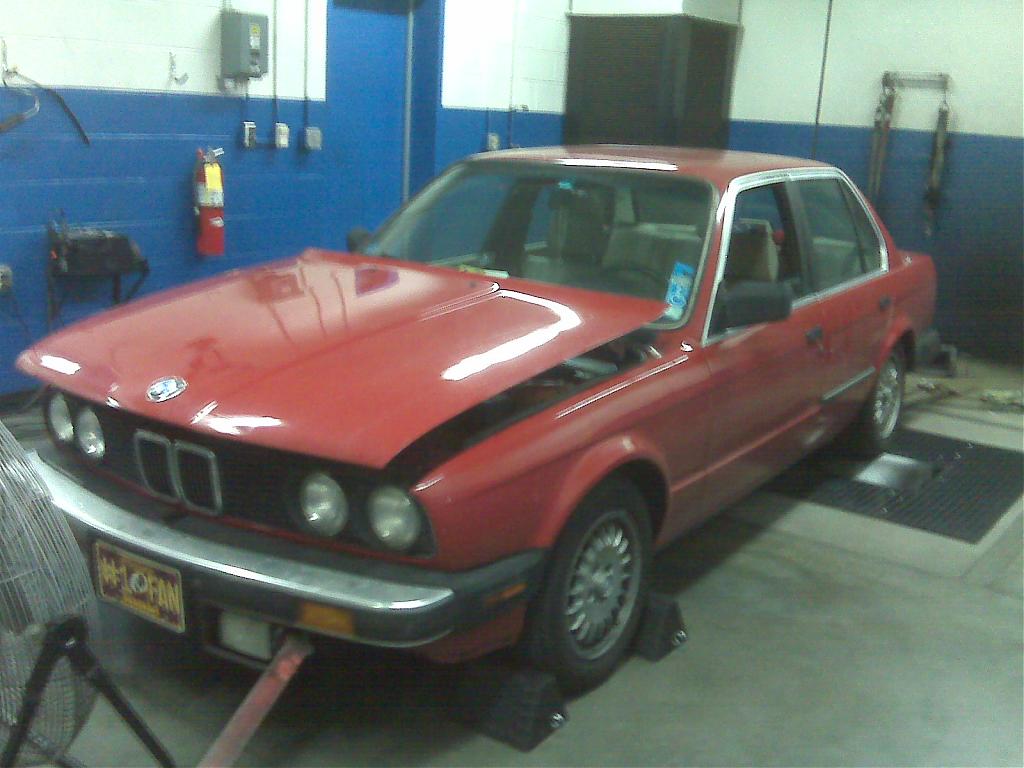

    Ran My 325e on the dyno stock with a ristricted cat and got 98 HP 137 trq.
    Then i put my chip from BAV AUTO ran it agian and got 115 HP and 154 Trq.
    Now i Put ceramic coated headers and tryflow exhuast, both for a 325i and i ran it on the dyno today and got 115
    I should atleast be hitting 150HP.
    WTF.... she is running lean. Do any of you have an idea what to check for. I am replacing my fuel pressure regulator. probably getting it off a 911 or maybe from Bavarian auto.
