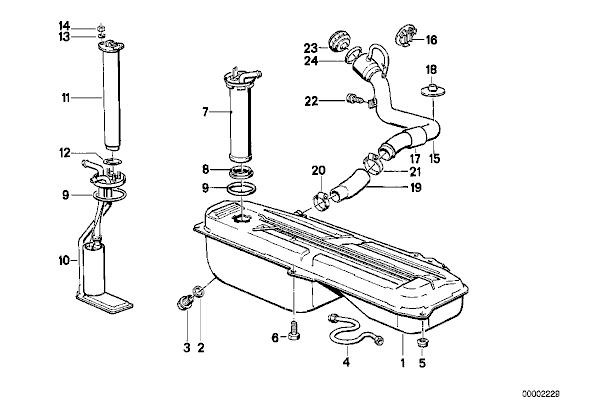

    Rubber fuel hose from filler to tank
    So here's a odd ball question. While I have the rear subframe out, I figured I'd replace the rubber fuel hose that goes from the filler pipe to the tank. I'm looking for #19 in the pic. The odd thing is that realoem and my friendly local dealer tell me that hose isn't listed past 1987 and I have a 1989. Anyone have a part # or can confirm that the pre 87 part is the same?

    Interesting. I did replace mine too, and maybe this picture will help. This is how it looks on my pre 87

      That's strange. Well, post here when you find out for sure. I need to replace the one on my '89 M3.
        Looks the same, maybe I'll take it off later today and it might have a sticker with a p/n somewhere on it. I'll report back

          If it matters the one on my 88 iS looks just like the one in the picture posted.

            I hate bumping an ancient thread, but the little search button got me here...so what was the conclusion to this topic? I am in the same situation and need to replace part #19

              It's the same.

                that diagram is for 84-87 cars
