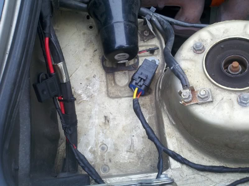

                        So since everything is installed and i didnt take pics as i went thru the process Ill explain everything the best i can..
                        Products I bought:
                        E36 318 dual temp switch for radiator 80/88 61-31-8-361-787-M85
                        Thermostat for 6 cylinder car 80 degree 11-53-1-466-174-80
                        redline water wetter for the coolant
                        spal electric 16" low profile puller fan: bimmerworld
                        SPAL fan bracket and strap mouting kit: bimmerworld
                        SPAL fan relay and wiring kit (not the one with the temp unit)
                        Keep in mind i have no ac so this setup prolly wont work if you have ac since you are taking the aux fan wiring temp switch..
                        This first pic is the relay wiring kit. It has a 12v constant, 12v ignition, power to the fan, and signal from the switch..
                        I wired the 12v constant to the battery terminal you can see in the pic above, the ignition wire i wired directly to the fuse box to the rear defrost because mine doesnt work.. i ran the wire thru the rubber part on the side and sealed it up with liquid electrical tape where you can see below.. the power to the fan wire is simple it will have a plug that plugs to the fan and there will be a ground that you ground separately..
                        For the temp switch the best way i found is to connect the signal wire to the wire that plugs in with the temp you want the fan to kick on at.. I picked the lower temp, the higher one i just capped off, then the third wire which is the one closest to the front of the car i put just put to a ground source.. normally its a powered thru the ac.. you want it grounded.. Now it will simply kick on when you hit the temp in the switch and will never have to think about it.. I used the stock fan shroud and just cut out a bit where i mounted the brackets which are on each corner of the radiator.. you can see it at the top in one of the pics.. also you can see that there isnt much clearance for the fan, i bent the brackets up a little so it off the radiator but not much.. as it is right now it works perfect for me..

                          why do you need a special relay.. there is already a high-current circuit and relay you can use that is wired to the thermoswitch.
                          Everyone *always* makes this so damn complicated. lol.
                          all you need to do is make sure the existing relays/fuses are working, swap the thermoswitch, and connect the power and ground to your new fan..
                            i tried that first actually.. wiring it through the ac system was more of a headache.. it either wouldnt work or just stay on all the time.. once i got that relay kit it was simple..

                            • nando
                              • 34844
                              it's not really the "A/C" system, although the A/C can turn it on, you don't need any of the A/C wiring for it to work. If it wasn't working right then something was shorted or a relay was bad.
