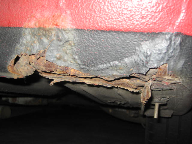

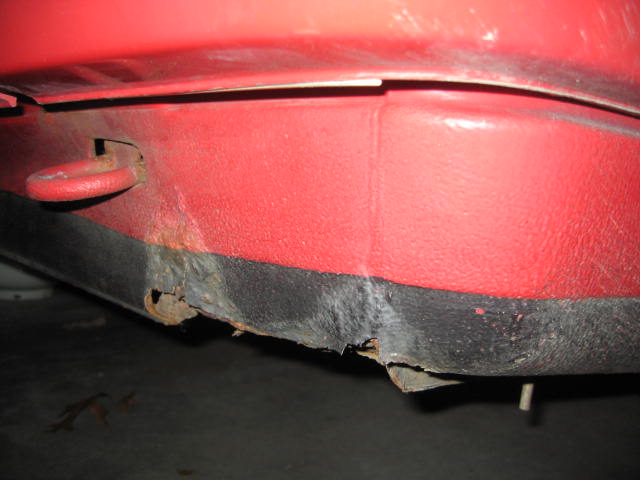

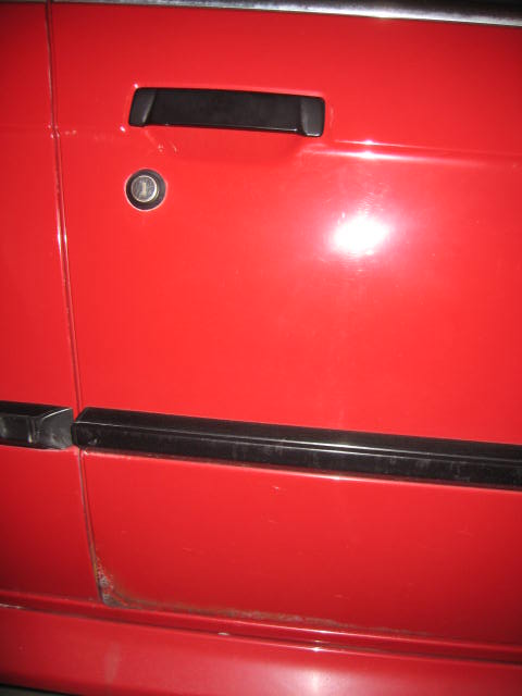

    I was wondering how hard would it be to fix the rust shown inthe pictures I have attached. Any input would be greatly appreciated Fellas. Thanks

    I am one week away from buying this car. This seems to be te only major issue that I can see.

      It wouldn't be too hard. just some bondo work. it depends on if you want it fixed or to drive a perfect e30. you can also just replace it. how much are you paying for it? any more pics?

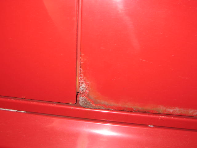

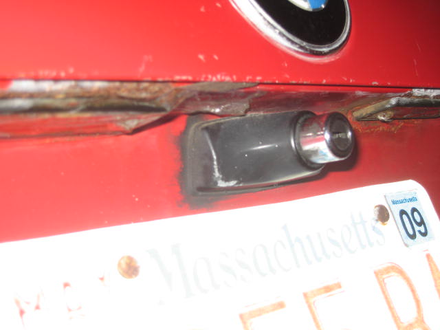

        here are a couple of more pics. I am paying about 4500 for this. Only 115k miles and most maintenance already done. Do you guys think that these things are a DIY for noobie such as me (in body work that is)?

          try to pull the rear carpet lining...and check the arches of the wheel well & strut mounting points on top if you can. Those were 2 spots that came to me by surprise on my old E30, one of which exposed my wheel thru the inside trunk. Also double check the rocker panels all around.
          Judging by those pics, there could be a lot more hidden areas.

              to be honest im not sure...a lot of the work to fix would have to be all fabricated...so it may get pricey. I saw the extent of the rust on my car (a bit worse than yours) but in all the same areas....and unloaded the car before I started to dump more money into it. If its just contained to the ones you posted, it doesn't appear to be that bad. You may find some hidden secrets though once you pull the front carpets.

                +1...that really looks like it may be rusting from the inside out. Pretty common here in NE. Have the car checked or low ball the guy.
                Actually, you might want to low ball anyway. I work for a shop that restores and sells old BMW's and MB's and NOTHING is selling right now.

                      $4500 is too much, especially for a northern rust bucket.

                        I'll bet there's more rust damage than you've seen. Just based on the pictures I'd say that the car is worth no more than $500.

                          i agree, thoes spots especially the doors point at their being more serious rust problems you done see/ wont untill you own it and have it up on a lift
