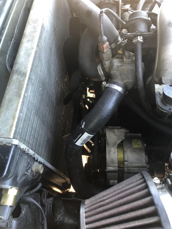

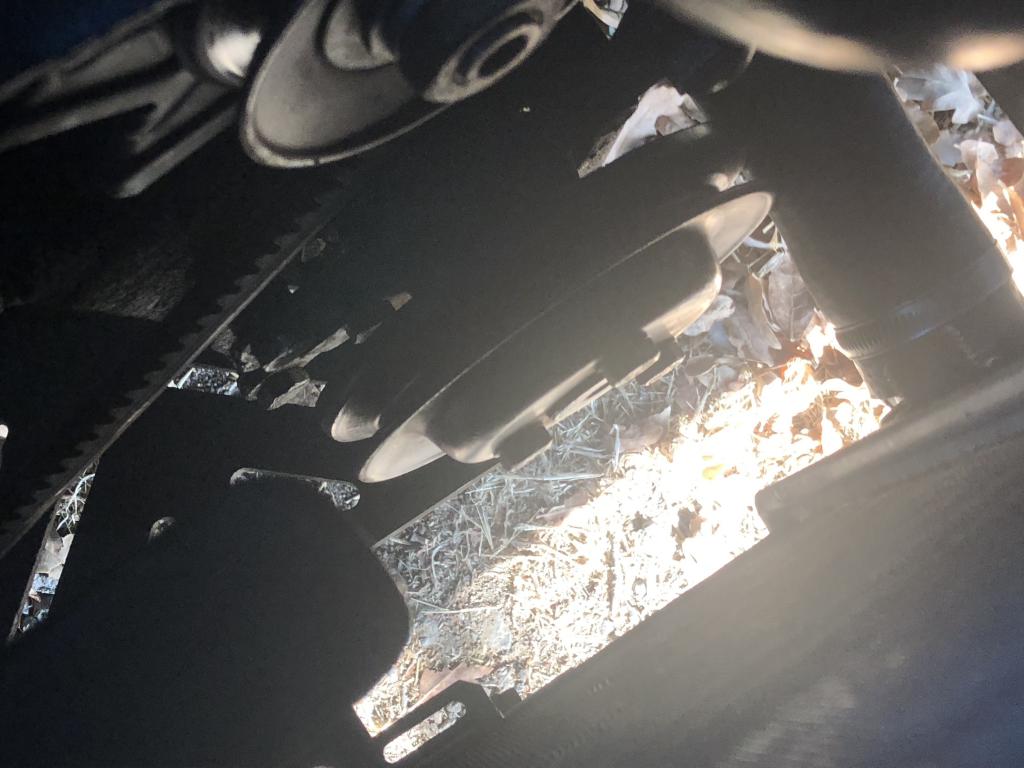

              Click image for larger version  Name:	uAfzOTnZTceIjHRc1Zrd9Q.jpg Views:	0 Size:	76.5 KB ID:	9863141

                1st photo is where it sits, took belt off so im not burning through hoses

              It’s a little dark to see the pic but.... are you sure you’re using the correct lower radiator hose? Sometimes switching different manufactures of hoses will have the correct bends giving more clearance Sent from my iPhone using Tapatalk
