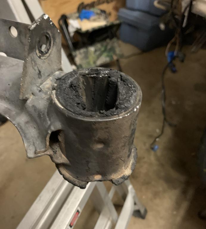

    I’m visual and many of the bushing threads pictures are gone. I’m at this point and am wondering how I should get the rest of it out.
    tips?

    Ideally with a press, however, I have also used a sawzall (very carefully), a chisel (I mean a screwdriver of course), and a hammer with a piece of pipe. Basically, get creative with the materials you have on hand and find something that fits.

      Some ideas.
      I would soak it with a lot of penetrating oil. It makes rubber very soft in no time.

        If it were me id take the subframe to a mechanic who has a press, get them to press out old ones, and press in new ones.
        Im sure its possible to get them out with various methods of cutting and grinding, but for 50bucks it will be done and then you just need to re-install.

          Thanks guys! I was able to get them out!

              I am assuming that the outer rim is a metal ring, I suggest this: Use a hack saw to cut through the bushings outer metal collar. Use a small chisel/screwdriver and tap it between the metal collar and the sub frame where the cut is causing the collar cut to roll/bend inwards. Try not to gouge the sub frame. Slowly tap the chisel down, rolling the collar inwards. You may need to go back and cut it as you go. When you have "rolled" the metal collar all the way through, it should tap/press out easier.

                Heating the subframe until the rubber melts makes them fall right out. There is a layer of rubber between the subframe and the metal sleeve of the bushing and when it melts, the sleeve will fall out. Might need an oxy/acetylene torch though, not sure if a propane one will get hot enough.
