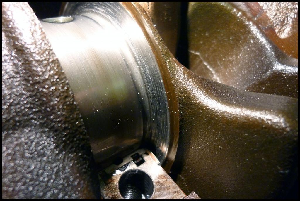

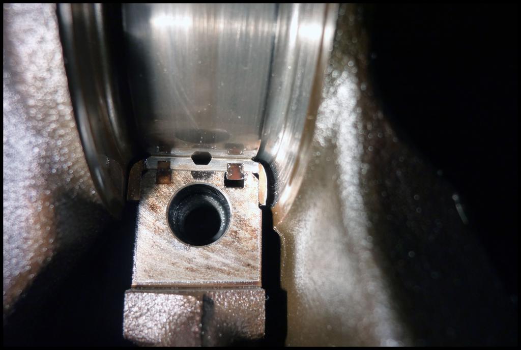

              Check for excessive crankshaft end play. The main bearing that has a built in thrust surface is only 180º and is known to wear into the crank and destroy it. If you pull/push on the crankshaft pulley (may need a pry bar to move it) and it moves back and forth any noticeable amount, you're going to need a new crank. If it checks out fine, put main bearing replacement on the list as one of the first things to do.
