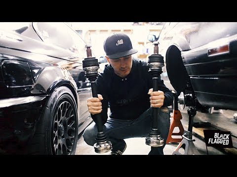

                        When I did my suspension overhaul, the rear axles were also hard to install. After making sure everything was clean and had no burs.
                        I made myself a tool like the guy in the video shows, worked great
