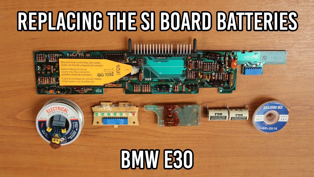

          If it's the fuse #21, the drain can be caused by the SI batteries in the instrument cluster.

            SI batteries in the instrument cluster, meaning, i need to take out the cluster and solder new batteries in or replace it altogether? can the car be driven without fuse 21?

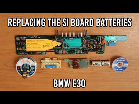

              You should replace the SI batteries. There are 2 types.
              You can remove the fuse 21 after a drive. Without it, the speedometer won't work, maybe something else.
              These are the newer SI batteries.
              Cluster removal.
              It's a good idea to change the odometer gears too.

                        i removed the gauge cluster and inspected the si board and it looks pretty straight forward from the youtube videos. i ordered a soldering kit and the SI batteries online.

                            I just want to add that I had this issue and I replaced my SI battery board and the issue went away. I used the programma SI batteryless board which was a good cost compromise vs getting a reman board.
                            EDIT: I should follow that up to say that only certain models of the e30 can use the batteryless board. Make sure yours can if you want to go that route.
