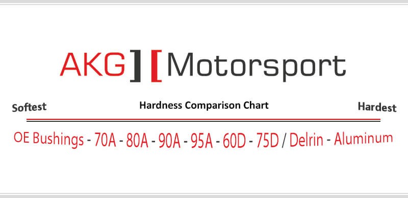

                I also found this to help out with selection. I have experience urethane under constant heat is not long lasting.
