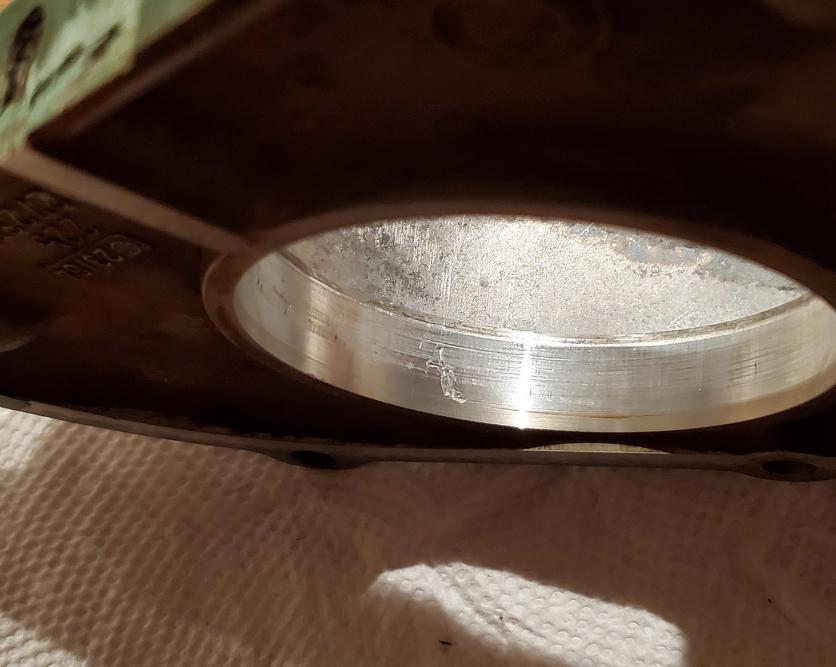

                Then I found that the Crank Seal Housing had some pretty good scratches. Not sure if that was causing it to leak, but for $65 I decided to order a new one and reduce the risk of continue to have leaks after the repair.

                Picture of the seal surface scratched in the old housing.

                  That scratch didn't matter much. You could use a gasket sealer.
