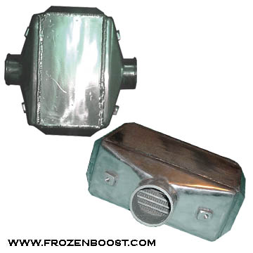

    I am going to follow the same path on the meth kit, maybe try and see if I could put a small air to water intercooler in the loop somewhere. Something like this possibly:
    I've seen many guys run e85 and meth and have extremely low AIT temps for a turbo, not sure if e85 is an option for your area though.
    A2W intercoolers are best for race applications. They SUCK on the street. Ask the Syclone/Typhoon guys. (I owned a Typhoon). I would find another option. There are plenty of E85 pumps in my area but with E85 you have to double your fuel delivery and my whole system is brand new and can support 550 rwhp or 700hp with a injector change. I would rather tune for 93 octane and use meth for insurance. Getting 600 rwhp from and LS1 turbo on 93 octane is pretty easy.
      That's really odd, I have a good friend that runs one on his turbo m30 and he loves it. we'll see, not having all the extra piping and hacking up the car would be really nice....Keep up the good work man, your car looks amazing.
