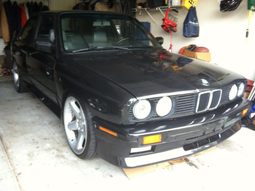

                      Pics
                      In NJ

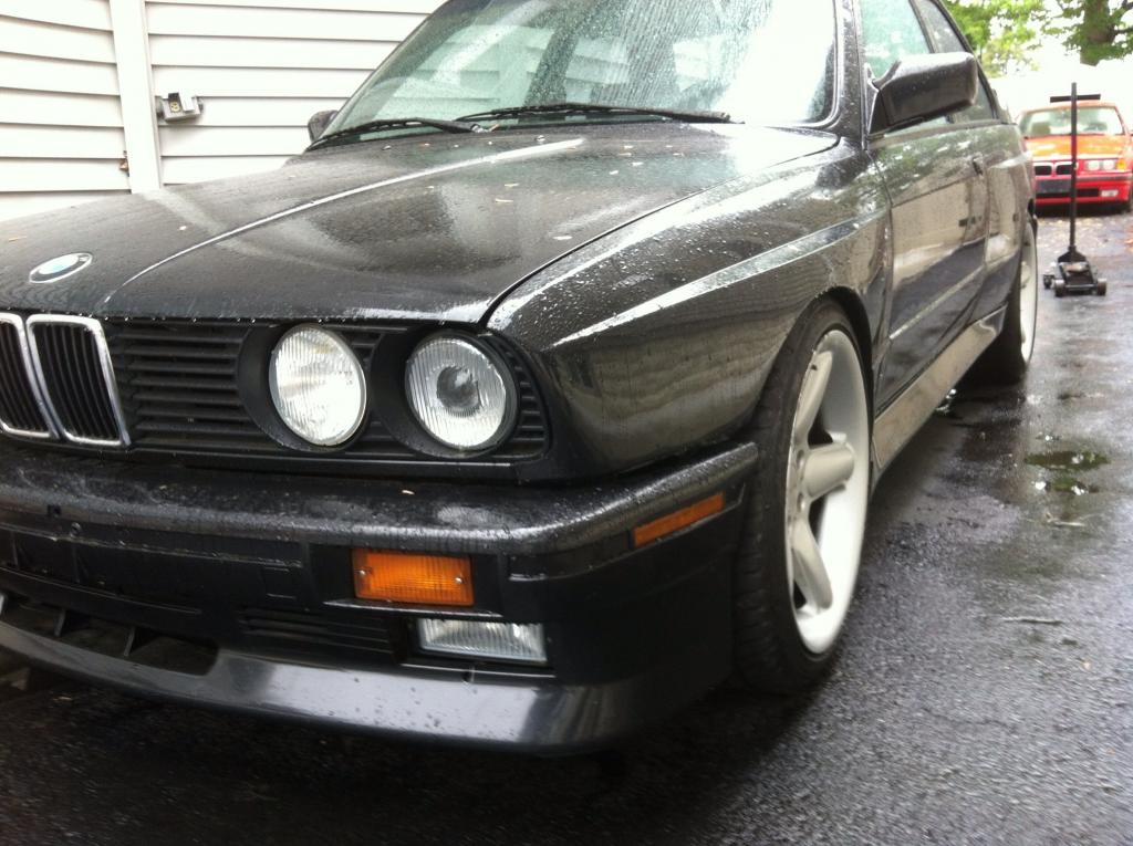

                      • dlighty
                        • Aug 2009
                        • 7
                        At home
