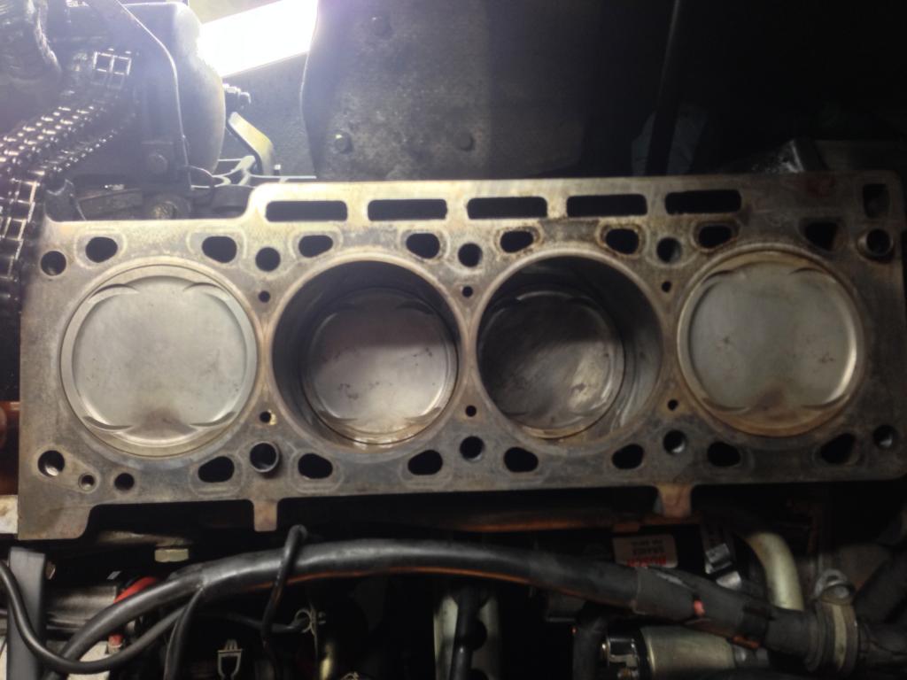

                  Today I got the chance to remove my cylinder head before I headed to work, and this is what I found. Carbon deposits on top of the cylinders.
                  So my question is, is this normal? And how can I remove the carbon deposits on top of the pistons without disassembling the pistons? I bought engine degreaser but I'm not really sure if the safest bet without your guys' approval first. Any recommendations on how to safely remove and clean the top of the cylinders?
                  -PCasil
                  IG: SJZOOSUAVEBOY
                    Yes, to a degree. Mechanics will typically clean them up with a wire wheel.
                    88 M3 - LACHSSILBER/SCHWARZE
                      Should I keep it on, or should I remove it? I'm hearing a lot of mixed reviews regarding to keep it on or removing it..
                      IG: SJZOOSUAVEBOY
                        Easy off the oven cleaning product works REALLY well make sure you clean up after it really well and your good to go
                          shiny pistons
                          I use brake cleaner, wooden dowels(aka chopsticks) and buckets of elbow grease!
                            Thanks for your input guys. I'll try to get it cleaned by tonight

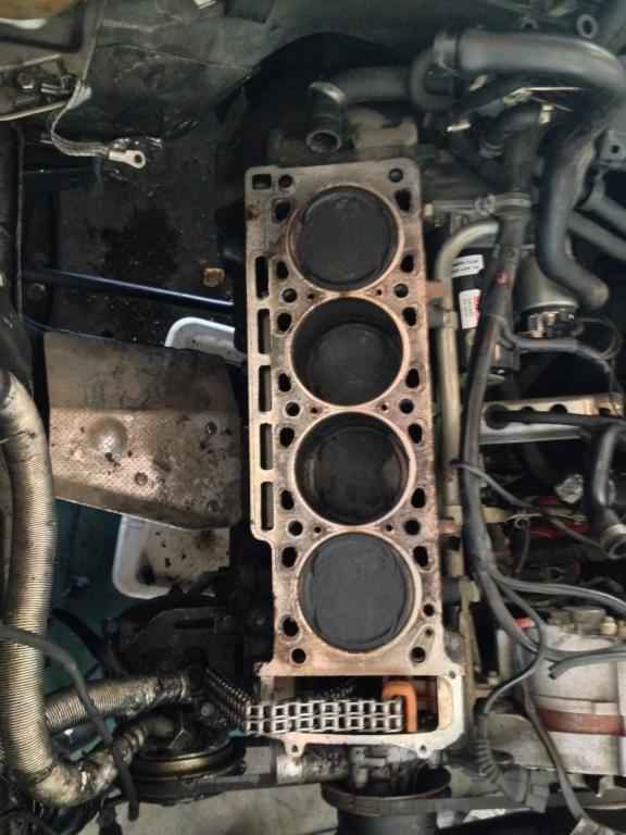

                              What do you guys think? Clean?
