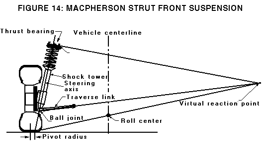

    Has anyone ever seriously looked at the various suspension motions when using this conversion?
    I've seen plenty of guides which imply it bolts together, and even some with alignment sheets and pictures of the wheel in the arch to show that the static alignment is acceptble, but has anyone ever really looked at:
    • Bump steer
    • Camber change
    • Roll centre height
    Given the price of the parts, I'd like to know the answer before settling on it, which means modelling the whole suspension. In the name of 'standing on the shoulders of giants' and all that, has anyone started or finished a similar exercise and happy to share their findings?

    You need to be an engineer to graph all the angles of the suspension and get an imagery of the theoretical roll center. Then there are so many applications (all 96+ components; 95 CA with offset CAB and 96+ spindle, non-M components, etc). So many different variations out there. Good question, but I have a hard time believing that someone drew out the geometry and all the angles to gather a roll center answer to this swap.

        I think everyone knows (or should know) the E36 swap does not give you proper geometry.
        Front geometry is not that hard to model. You can use a protractor with magnetic base to get the angles.
        I dont think the RC would be worse with the e36 stuff. The castor is most likely the most messed up.

                        the tie rod balljoint's pivot point is about an inch lower on an E30 strut than an E36 spindle, which influences bump steer.
                        the relative position of the virtual axis of rotation of the front wheels is also completely different from stock e30 *and* from how the suspension is mounted in an e36, as are the camber and caster curves, which implies that it doesn't work as engineered.
                        unclear what the physical effects are.
