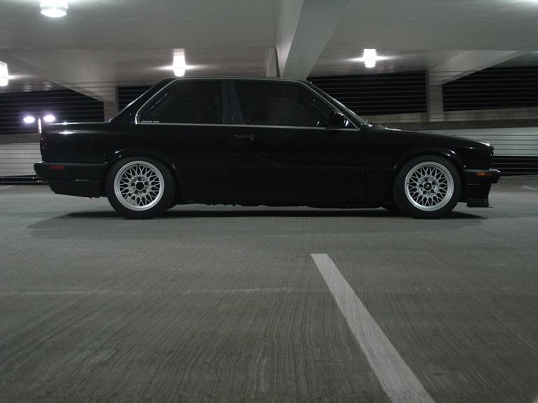

                      Are you referring to this setup I have?
                        Originally posted by Lof8 View Post
                        Does an e30 m3 5 lug setup change offset compared to a regular e30 setup?
                        In short, yes it does. To be exactly where I had those sitting, you would need a 5mm spacer.
