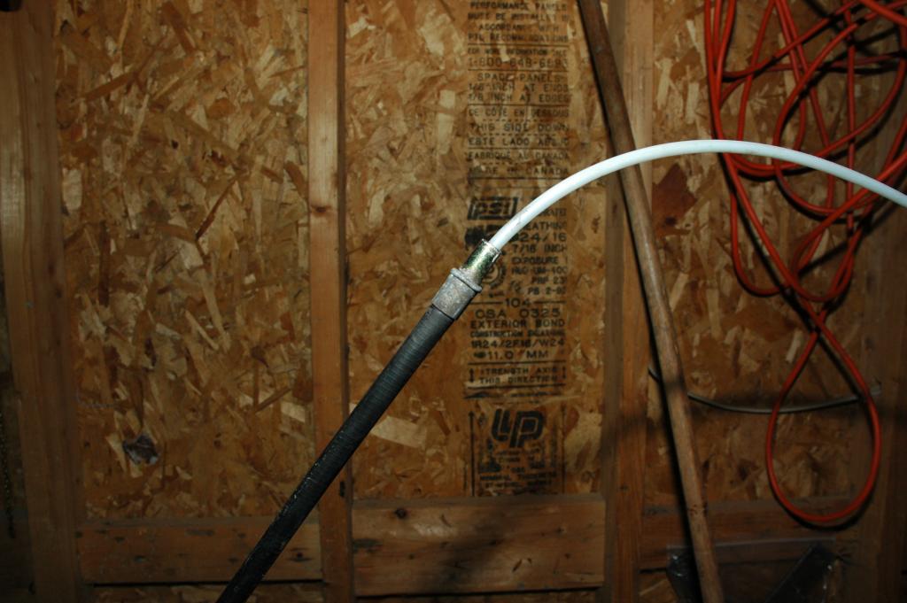

                  10 minutes? It's already taken me an hour to pull one cable out of the arm! I had to destroy it to get it out and it involved liberal use of oxy-acetylene. I would not take getting the cable out easily for granted.
                  I'll be buying new e30 cables.

                      I just got the e30 cables in the mail...
                      comparing them side by side the e30 parking brake cables have a much shorter black body and much longer cable coming out of th end that feeds into the cabin.

                          I would say the chances or successfully removing and re-using original e30 cables are asymptotically approaching zero. The metal sleeves were so tightly fused into the hub that I had to destroy them to get them out.
                          The new e30 ones had plastic and won't have the same problem. (unless all e30 are plastic?)
                          The lesson is, don't count on re-using the cables, order new ones!
