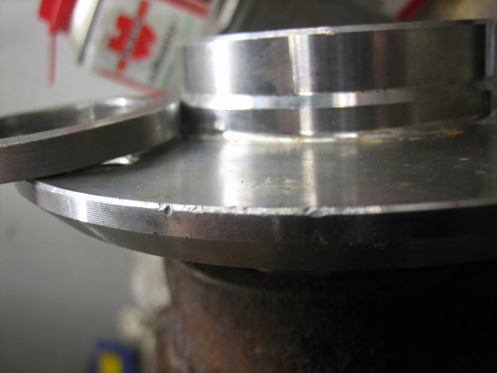

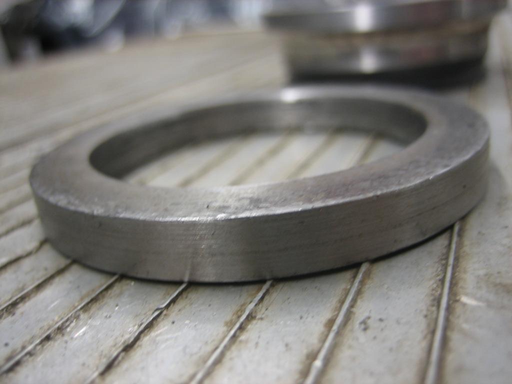

      The 6mm spacer, not radiused so it doesn't fit the hub correctly yet:

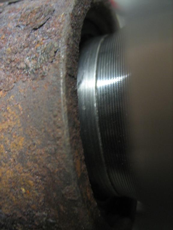

      Hub and spacer pressed to bearing, the rusty part is trailing arm:
      The reason why rotor spacer would be hard to fabricate, see the 2 different centering thicknesses, the one for the rotot is about as sama width as the spacer would be... can't explain any better, if you don't understand what I'm trying to say just try to draw such a spacer.
      The weakening part mentioned applies to stubaxle(or what ever the end of the outer cv-joint is called) to hub contact, the splined contact area will be reduced compared to original, but not much. Like the splines don't "meet" on full lenght.
