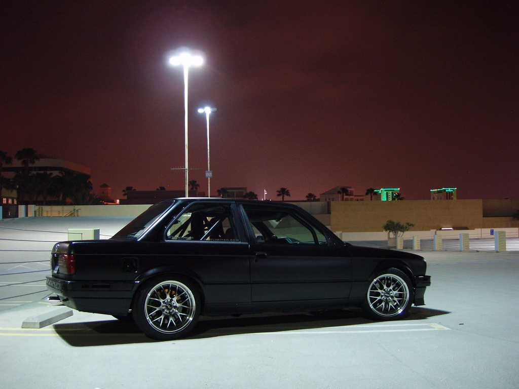

17x9 ASA AR2 ET45
235/40/17 Nankang (shitty) tires
Vorshlag wheel stud kit
Front:
E36 M3 Bilstein strut assemblies
Eibach J-Stock springs
New E30 upper strut mounts
97 M3 control arms
Drilled and slotted rotors
OEM E30 M3 CAB's
Vorshlag 10mm spacers
Rear:
M Coupe trailing arms
M Coupe drive axles
Bilstein Sport shocks
IE Stage 3 springs
IE billet shock mounts
IE street subframe bushings
IE trailing arm bushings
IE weld in camber correction
Custom brake hard lines
IE SS soft lines
Still planning on front camber plates, upgraded sways with M3 style front link... and eventually some sort of coilover setup. I'm definitely in love with the way it drives, handles, and stops though!! Oh, and I am not running ABS.
