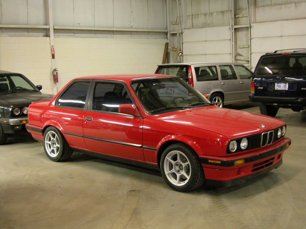

            E36 m3 front with shocktowers drilled to use 96+ e36 m3 strut hats (more caster). Oh yeah, running L hat on the right and vice versa, more camber that way. In addition had to shim strut where it attaches to knuckle to get ~2* camber. E30 m3 control arm bushings.
            318ti rear
            E30 m3 springs, and e36 konis all around (no issues with rear which is cool).
            DS1 powdercoated mirror black with 215/40/17's. Currently refinishing some 16x7.5 et35 3 piece fittipaldis that just BARELY clear the m3 brakes, gonna rock 205/40/16 Azenis RT615's i have laying around from my VW days.
            Don't really have any good pics of it, have some showing the shiny wheels and one of what I did to the shocktower.
            Car is up on stands with no motor awaiting s52 powah for spring.

                      I love the way your E30 looks with those E36 motorsport wheels.. I may have a lead on a set of those for myself but i wasnt sure how they'd look... thanks for posting that pic.
                      For the time being i have a set of 16" style 30 wheels.
                      still waiting for bavarian auto recycling to send my rear Z3 hubs.. do these guys normally take forever to get stuff out? i guess they must be busy as hell most of the time
