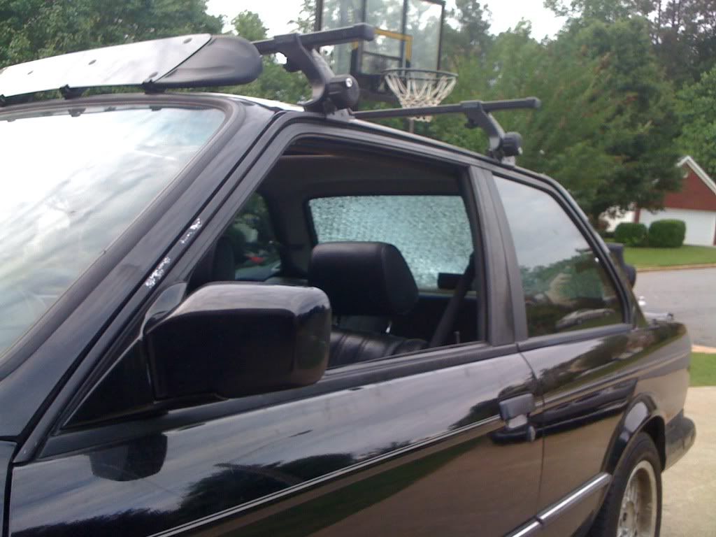

Rear Window Shatter While Removing Subframe

    ^ wtf was so hard about undoing 2 bolts?
    usually they blow from bad defroster traces right?

              the sunroofs on the e90 chassis cars have been known to do this. its an issue bmw has still yet to do right. the e90 ones are believed to have to do with pressure buildup in the cabin on the highway.

                  Originally posted by cobraken
                  Was your statement above stating that this damage had been done by using the rear defrost over a period of time?
                  The battery was disconnected because I am also in the middle of an e to i engine swap.
                  No, I didn't mean that. The thermal stress from the rear defroster is greatly reduced when the heat is removed. There will be a little residual stress added, but it should be much less than the stress created from the glass tempering process.
                  I don't know what caused this, but it wasn't the defogger grid that is the typical problem. It's a bit of a mystery -- I just didn't expect it was pressure from a twisted body.

                      Noted back glass.
