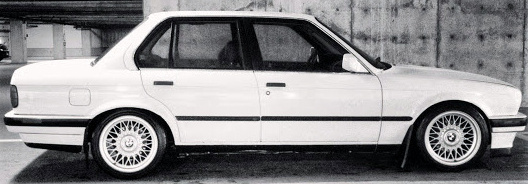

                    I just emailed jon @ treehouse with the concern that my wheels moved further forward to the point where they rub the inner fender liner (stock bottle caps) when I installed the thr cabs with brand new Lemmy control arms.
                    He sated this should not happen as the CABS were designed to have the same specs as oem m3 cabs. He then went on to state that he believes the specs on the control arms have changed over the years or are differnt from supplier to supplier. I wish I had my original control arms to see, because my wheels were not this far forward with my original arms and oem m3 cabs.
                    He also stated this huge increase in caster is fine and will not be a safety concern. So now I get to say because racecar everytime someone asks why my wheels are so far forward lol.

                      I just installed the same as above and am experiencing the same "wheels pushed forward" as seen in the pics earlier in this thread. So my question is, does everyone with the treehouse eyeballs end up with this? Or is it really that lemforder(sp?) just up and decided one day to change these control arms...seems weird.

                        The only other thing that would affect the position of the wheel would be the subframe. Is it possible yours is bent or something? Maybe adding the mounts amplified some damage that had been there.

                          I have THR CABS and my wheels are way more centered in the wheel wells, compared to the 2nd pic posted above. The first doesn't look too bad, but the 2nd one doesn't look right.

                            There is some misunderstanding between you and Jon, he is talking about how those are made specific for m3, not regular e30. m3 and non m3 have different CAB so of course your suspension is going to be whack outwith an alignment.
