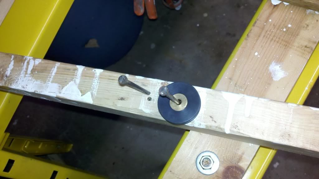

                As long as you use the correct flare wrenches, you shouldn't damage any lines. Just rig up a good system to bend the lines proper and knock it out. I got a wooden board I found lying around, put a couple nails in it and borrowed some pulleys from a set my dad has for an airplane he's building. The grooves in the pulley were perfect for seating the line, and I applied the right pressure to bend the line without crimping or damaging it.
