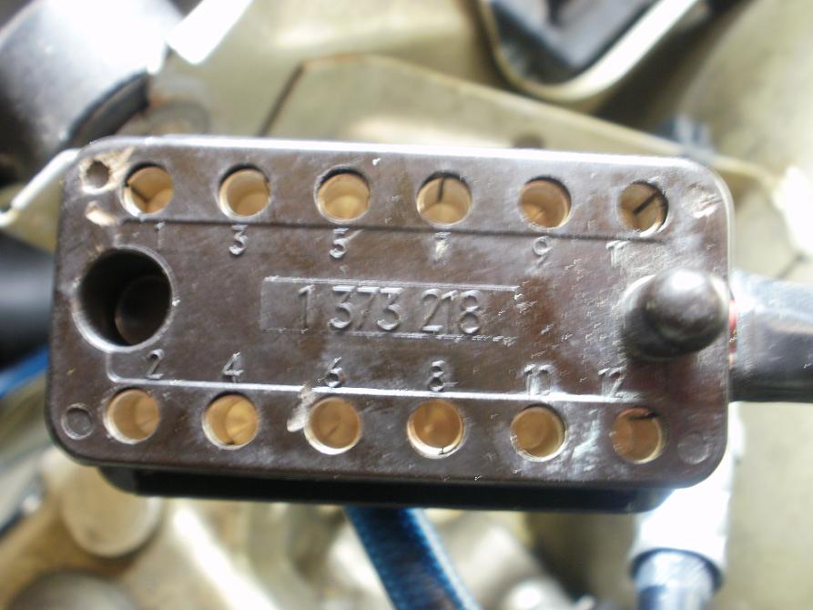

    I could relay my really lengthy saga trying to get some pedal feel out of the brakes & air in the abs unit, but, really, ya'll would be asleep by the end of the story. Out of time and desperate for brakes before an event, with an extra set of ss-lines on hand, I bypassed the ABS unit. Last year I was determined to get it back, and opted to leave no brake-bleeding stone unturned.
    Anyway - sitting here without pics and a bit from memory, what I did to get the abs unit to cycle was jumper 87 & 30 connections on the abs unit as shown in the OP's pics.
    Obviously that means popping off both relays and wiring up some jumpers - easily enough done with some radio shack connectors of the right size & a short length of wire.
    Apparently in shack-speak, these are either "Bullet" crimp connectors, or maybe "Snap" connectors, along the lines of:
    Welcome to RadioShack's official website. Search and shop for electronics, gaming devices, powerbanks, audio products and business traveling gear.
    I had a selection on hand from which I was able to use the right size, but I'd have to go dig 'em up to be more specific on which connectors I used - I think they had yellow plastic on the bases for a larger gauge wire than the links above.
    Jumpering like this is all done up at the abs unit, no getting under the dash or accessing the ABS electronic control brain/module in the interior.
    The OP's pic shows the topside of the plug that plugs into the abs unit with the plug cover removed, and the plug still plugged in. I left the cover on & simply unplugged it (I think the cable is clamped in place with a plastic bridge piece secured by a couple of screws, maybe torx), and used jumpers between the plug and the abs unit (again, pretty easily wired up w/ right-sized connectors sourced from radio shack).
    I ran two jumpers out of one connector for power rather than make up a jumper for the two power connections of pins/plugs 6 & 12. I just split the power coming out of plug pos. 6 to pins 12 & 6 on the ABS connector; these are the pins that get power to the relays/circuits, which you can see at the top of the wiring diagram at the beginning of the thread.
    With the relays and power connections jumped, all that's needed to actuate the solenoid valves is to ground the pins for the solenoid valves in the ABS connector (at this point, I left the jumper for the ABS pump relay unplugged from one of the plugs, either 87 or 30, it doesn't matter which).
    Since the pins in the E30 ABS unit are pretty-good sized, I think I was able to find a female plug out of my Radio Shack connector selection to fit pretty well without having to go to great efforts to make something fit. Come to think of it, I think I actually used a small alligator clip that had a plastic cover that would cover the full length of the clip & clip jaws. I ran a pretty good length of wire out from the plug for the solenoid pins as I needed to be able to cycle the solenoids while sitting in the car.
    The wiring diagram shows the solenoid valves are ABS connector pins 1, 3, & 5. The numbering pasted in on the 2nd pic of the connector (1, 2 & 3) at the beginning of the thread are the wires for the solenoid valves, but do not correspond to the wire diagram or connector numberings. Both the plug and connector have numbered positions molded in that are easily seen, but you may have to look closely (they're small - see attached pic for reference).
    In this case,
    pictured 1 = wiring diagram connector position 1,
    pictured 2 = wiring diagram connector position 3,
    pictured 3 = wiring diagram connector position 5.
    To start, I plugged onto connector position 5, the rear solenoid valve.
    Then I connected the wire to one clip on a starter switch -
    (one of these: http://www.harborfreight.com/12-volt...tch-35448.html)
    and the other clip was grounded to something, anything grounded will work - shocktower mount bolt, etc.
    For the ABS unit to get power, the ignition switch needs to be on, I forget if in the accessory or run position - anyway, either one or two clicks forward, no need to turn to "start" position which would crank the starter & start the car.
    With the ignition switch on, you should be able to push the button on the starter switch and hear the solenoid valve click. The starter button is spring loaded, so pressing and holding the starter button closes the solenoid valve and holds it closed, until you release the starter button. Multiple button pushes = multiple clicks.
    Theorizing that normally, the ABS pump only operates at most for a few seconds at a time, I left its relay un-jumpered so it would not be running any longer than necessary.
    The bleeding process, it might be handy to have a second set of hands, but that was not an option for me, so I had to procedurally compensate, but I think to no ill effect.
    At this point, the valve relay is jumpered (87 & 30), the ABS pump relay is, uh, half-jumpered, the power is jumpered (connector 6 to pins 6 & 12), and connector pin 5 is connected to the starter switch, and the other starter switch clip is to ground.
    Then, pressure brake bleed as normal; suck old fluid out of reservoir, fill with new, connect & pressurize pressure bleeder, and bleed the rear passenger side caliper until you have new fluid at the caliper. Once new fluid is to the bleeder bottle, I shut the caliper bleed, went up, and checked the pressure level on the brake bleeder; re-pressurize if necessary. This is where help would be, uh, helpful - not having any extra hands to solicit, I made sure I had enough fluid in my bleeder bottle (a Bavauto brake-bleeder bottle, but anything might work) to ensure the end of the brake bleeder hose was thoroughly and completely submerged in brake fluid, and the bottle would stay in position and keep the end of the hose submerged.
    Then, I cracked the bleeder open, went back to the front of the car, plugged in the ABS pump jumper (87 & 30, and if in a bit of a hurry, don't mix them up), which started the ABS pump running. Then, I hopped in the driver's seat and carefully grabbed the starter switch (remember, with long wire leads to keep in reach while seated in the car and not pull the clips off whatever you're using for a ground point or the connector-pin plug wire.
    With the ABS pump running and the bleeder having been cracked open, brake fluid is being pushed through the system. A few clicks of the starter switch to cycle the solenoid, and then, press the brake pedal down to additionally flush the system. While pushing the brake pedal down (not too fast) cycle the solenoid repeatedly (ie, push the button a whole bunch of times rapidly) to your stop point pushing down.
    If you have an old/older brake master cylinder, it's probably not a great idea to push the brake pedal full travel all the way to the floor, as you run the risk of blowing the master cyl. internal seals if there's any corrosion/rust/etc. on the master cyl. piston area that moves through the seals. If that's the case, push your brake pedal only as far as you would when driving the car.
    Having reached the stop point, I released the starter button to ensure the solenoid was open, and let the brake pedal come back up, again, not too fast. The reason for keeping the bleeder hose submerged is to not risk drawing any air back into the bleeder line. If you have someone helping, they can close the bleeder when you say stop at your stop point, & you can then let the brake pedal come back up - and, they can observe any air bubbles coming through the bleeder. If you don't have anyone helping, recording some video of your bleeder hose while you're in the car might be used so you could observe if any additional air is pushed through the lines.
    Again, not wanting to risk over-running the ABS pump (not sure if that's possible or not, but, hey, just in case), I repeated this bleeding process pushing down the brake pedal 3-5 times, each time cycling the solenoid while pushing down. When done with that corner, it's hop out, close the bleeder, and pull one end of the ABS pump jumper wire. Check bleeder for pressure & fluid level, and repeat the same process for the left rear side. As you go, you'll feel the solenoid closing, as the brake pedal will stop moving down as you're pressing.
    When the left rear is done, then move the solenoid plug to connector pin #3 - re-check the bleeder fluid and pressure level, and repeat the bleeding process as described for the front passenger side caliper. Finally, move the solenoid plug to connector pin #1, and repeat the whole bleeding/cycling process for the left front (driver's) side.
    After bleeding/cycling each corner, turn & remove your key from the ignition, undo the bleeder & get all that back together and back at the right level, etc. (I presume that's covered thoroughly elsewhere in other diy's), undo the jumper wires, plug the ABS connector back into the ABS unit, secure the cable clamp and screws, plug the relays back in, and secure the relay/connector cover to the ABS unit. The only thing I can think of I might be forgetting is if there's a release clip on the E30 for the connector; there is for the E34, it might have to be pulled or whatever before being able to pull the connector free. In any case, that should be easy enough to see when removing the cable clamp and prising the connector free.
    This can take some fluid, so 1 liter may be cutting it too close - better to use 2 liters in the bleeder than risk running out & putting air back in at the top end, which obviously would be exactly what you wouldn't want to do, and require re-bleeding.
    Barring any problems with caliper pistons sticking, poor pad performance, or the like, this is, as far as I know, just about all you can do for a really thorough brake bleeding. If you get good pedal feel after this, then going forward, pressure bleeding normally is likely to work just fine.
    I know the diagram is for the E30 M3, but comparing the diagram to that in the E30 ETM (electrical troubleshooting manual) I don't see any difference, it looks like all the E30 ABS systems are the same, 3 channel. Comparatively, the E34 ABS system is 4 channel (ie, has 4 solenoids and separate actuation for each caliper).
    Googling should turn up places that host .pdf versions of the E30 ETM - I can try and dig up one or two if necessary.
    Looks like this was a thread from the dead recently resurrected, thought maybe my experience might be helpful. Cycling these early ABS systems takes deciphering the wiring diagrams and a bit of wiring effort, but otherwise is straightforward - I've been wondering for years how to do it, with what's been posted elsewhere, figured this much out, hopefully of help to others.
    A pressure bleeder is a must for this procedure, the positive pressurization of the brake system I think is far more effective for getting any air out vs. something like a vacula.
    Disclaimer: this worked for _me_; ymmv. Plugging & jumpering wirings opens up the possibilities of human error with potentially shocking/fiery results, so double-check everything for yourself and proceed with caution. Adding fuses to any wires/jumpers etc. _may_ be a good idea just in case of crossing something up, although I didn't bother. Remember, it's the internet & it's free, sometimes you get what you pay for - if there are any errors, they are unintentional, but I'm not making any guarantees either!
