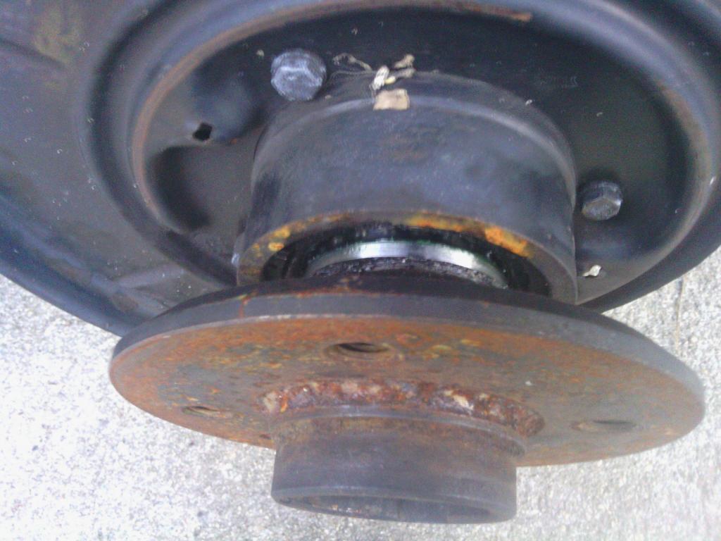

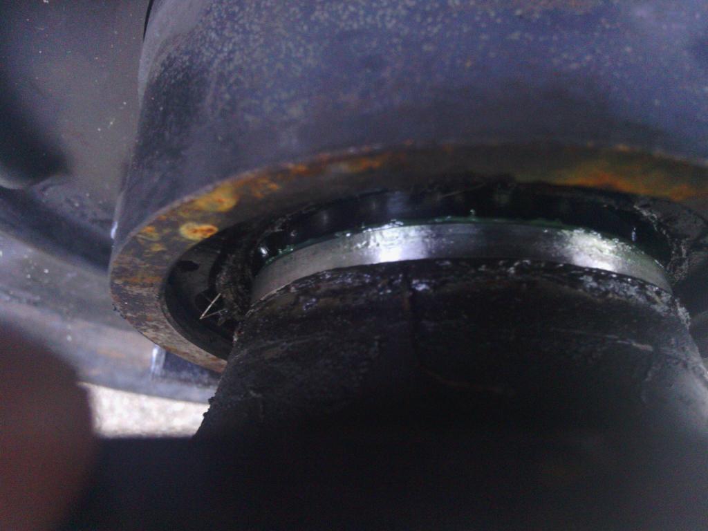

        I had bought some FAG wheel bearings and had them installed put in, well I went to put the axles back on and while trying to beat them in there my wheels bearings split in half -_____-

            should have used a little more grease on the axles then, they got about 1/2 way through and the wheel bearings just split.

                      What is the name of that tool you are talking about? and yeah I beat the "can" and that's how I managed to get it in half way in (that's what she said lol) and I did jack up the trailing arm a little to see if the axle "pushed itself" in place but it didn't and the wheel bearings gave out.
