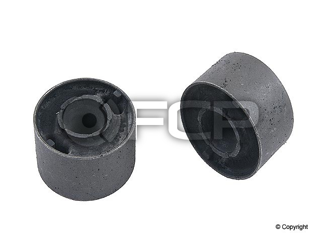

    I'll be replacing my bushings soon and do not want to add castor but I do like the idea of a solid rubber M3 style bushing vs the webbed stock style. I saw a pic of one recently (with the hole in the center) but cannot for the life of me recall or find what year\model it applied to.
    Anyone ?

    The 96+ E36 M3 bushings are what you want.

      Thanks for the info. I found these Lemforders which are better than the webbed version but not solid. Would another brand or OE be completely solid or are these as close as it gets ?..or is that just a dent and they are essentially solid ?

        Pretty sure condor speed shop sells non m3 solid bushings, but they are derlin not rubber.

          I have seen those. I'm really fine with the mild tweak of solid rubber, but I appreciate the suggestion.
          Those Lemforders will work but I was sure I saw a pic of 100% solid rubber.

            I had thought there was a solid version too but I can't find it.
            I'd just go with those E36 M3 bushings. I'm sure they'll last a very very long time.

                            Which rack are you using? I swapped in a 1.9L Z3 rack, which has the tightest ratio of the racks that you can swap in easily (according to Jordan / Stuck).
                            I have used the same mostly-solid M3 CABs shown above and they seem to be fine. No tears, a little stiffer and still a nice ride.
