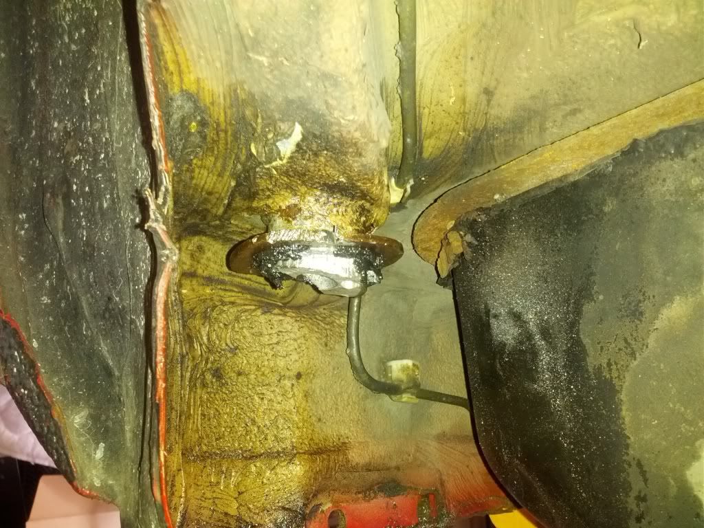

              • Cletonius
                • 2809
                This is what I've got:

                • IronFreak
                  • Dec 2012
                  • 3702
                  is the bolt still inside that of just the sleeve?

                  • JGood
                    • Jan 2004
                    • 7959
                    Yeah, that tends to happen on rusty cars. Just drill/chisel all of that old inner sleeve out. It's a complete PITA.

                    • Cletonius
                      • 2809
                      The bolts came out very easily, one hit. They had no corrosion whatsoever on them.
                      This is really the only issue, everything else has been fairly easy.
                      Edit: I'm thinking about trying to turn it with a pipe wrench. Good idea/bad idea?

                            • Cletonius
                              • 2809
                              I ended up getting it out.
                              I broke off as much as I could with a chisel, then a ran a small drill into the aluminium. I then used a screwdriver and mallet to break out the bushing.
                              Once it was out we examined it. Looks like the installation glue from above managed to work its way into there somehow. Its clearly a tan glue like what was on top of the bolts inside the car.
                              Reassembly this weekend. Any harm in putting some antiseize in there ?
