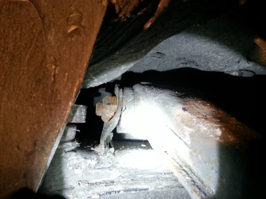

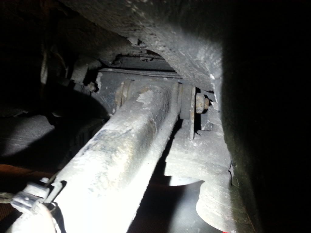

    So I've reached the tail end of a full suspension rebuild due to a minor wreck, and I'm stuck on how I should go about an issue I have with my driver side trailing arm. I was putting on my new rear axel on the driver side (old one snapped) and noticed it was a really tight squeeze and required a scissor jack between the diff and lower shock mount to fit in there. Found out that my trailing arm mounts on the driver side of the rear axel carrier are bent. I thought of just dropping everything down and bashing them straight with a hammer, but there is so little room to move in that area that I would like some other input before I just go to town with the hammer.
    Main issue I'm having is I don't want any un-nessescary pressure in the new axel I just installed, and a more minor problem it is causing is that it is giving me a few degrees of positive camber on that wheel which is making it really hard for me to kill the stance game.
    Any input on this would be appreciated, would really enjoy not having to drop all the suspension if I don't have to.

  • bmwguy325is
    • May 2011
    • 1262
    Ya you need new sub frame or legit repair. The arm itself may be bent
          Please do not ever do this...
          That needs to be replaced. You can come close to getting it back into place, but you will strain to metal. That is a highly stressed area and I would not recommend doing that for safety reasons.
          Spend the couple hundred dollars and a weekend to replace your subframe, and verify that your trialing arms are straight. While you are in there make sure your body is straight...

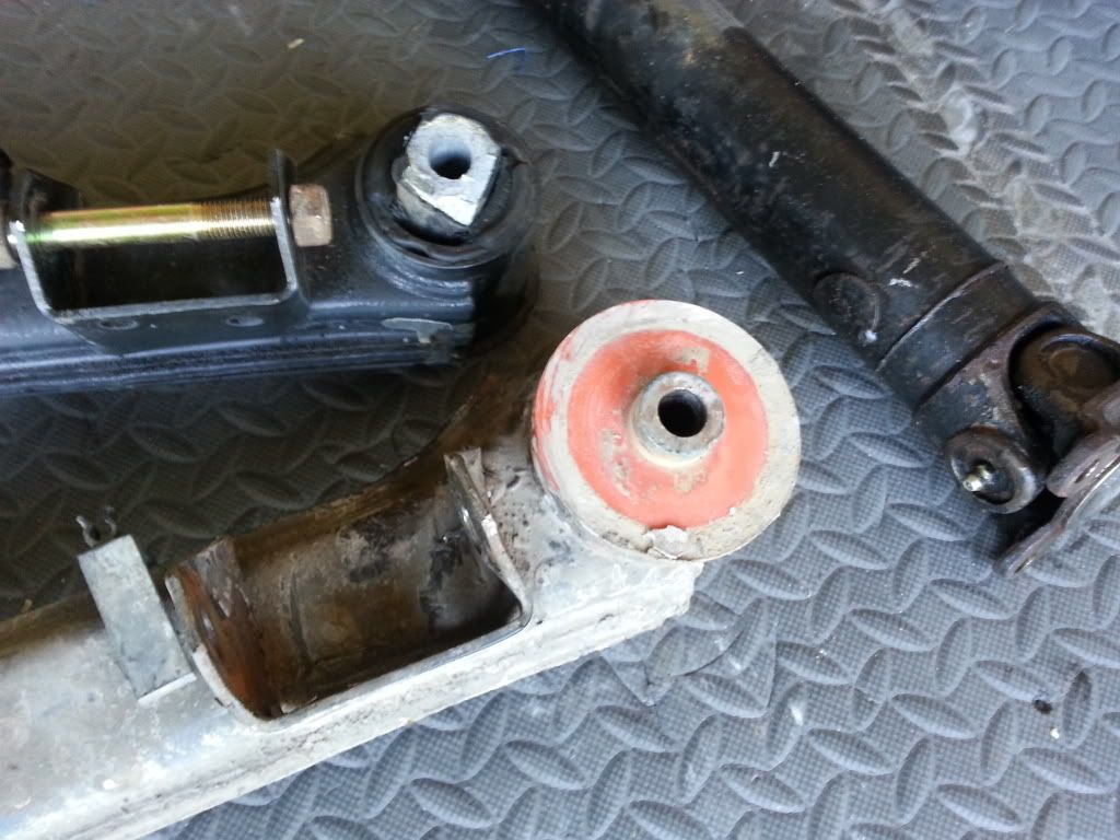

              Got my new sub-frame today. Took out everything that is holding it to the body and now just need to get it down. Any preferred method of doing so? Would really like to save the bushings it has because the new sub-frame's bushings are shot.
              • Cletonius
                • 2809
                I'd replace the bushings.
                Easiest way to get the thing out is to thread a 5/8" lag bolt into the bushing from underneath, then put a 18" round punch in the hole from inside the car. 1-2 hits with the sledge and the subframe should drop.... as long as it doesn't get stuck.

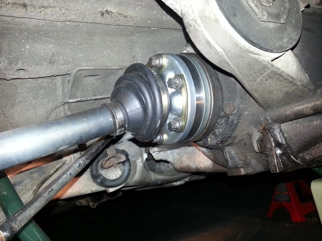

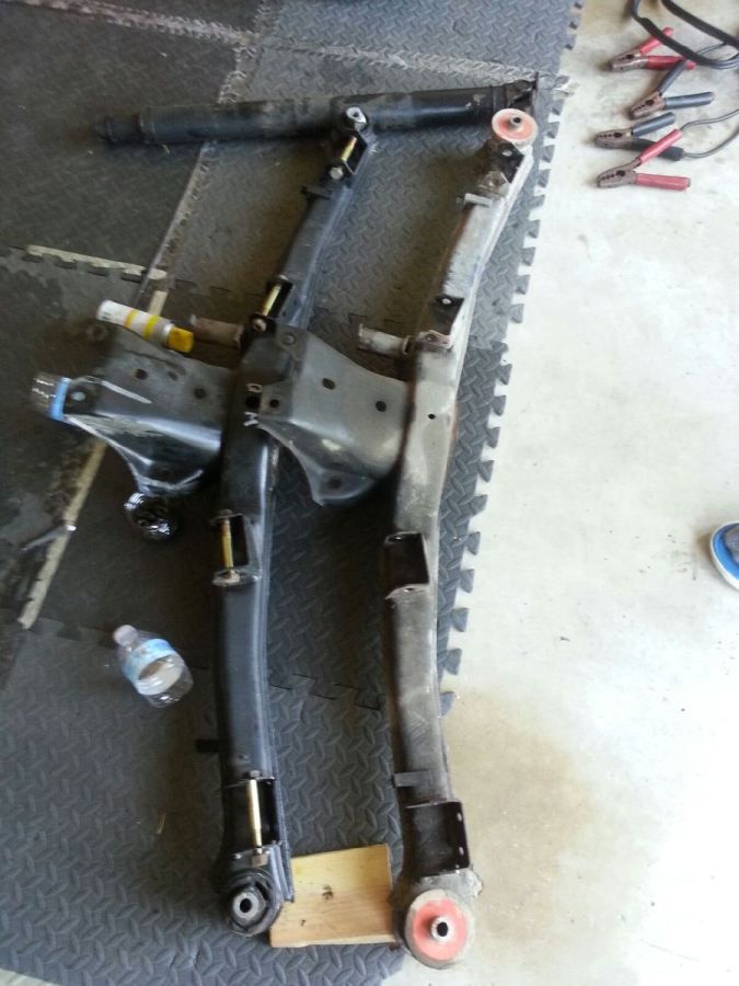

                    Made some good progress today. Got my old subframe off. Looks like the trailing arm held up to the impact and didn't bend, but won't know for sure until we start piecing it back together. One downer is that I accidentally pulled the rear part of the driveshaft back too far while dropping the diff down so now I have to either keep trying to shove the shaft in blind until I line the splines up, or remove the whole exhaust along with the exhaust guards just to put it back in. Still haven't decided what I want to do in that situation. On a positive note however the old subframe and trailing arms have poly bushings already. Need to find a way to get those out because the bushings in the new subframe are SHOT.
                    My buddy (A.K.A. my mechanic) basking in triumph upon the removal of the old subframe.
                    Kind of hard to see, but this is the trailing arm mount comparison. New is on the left.

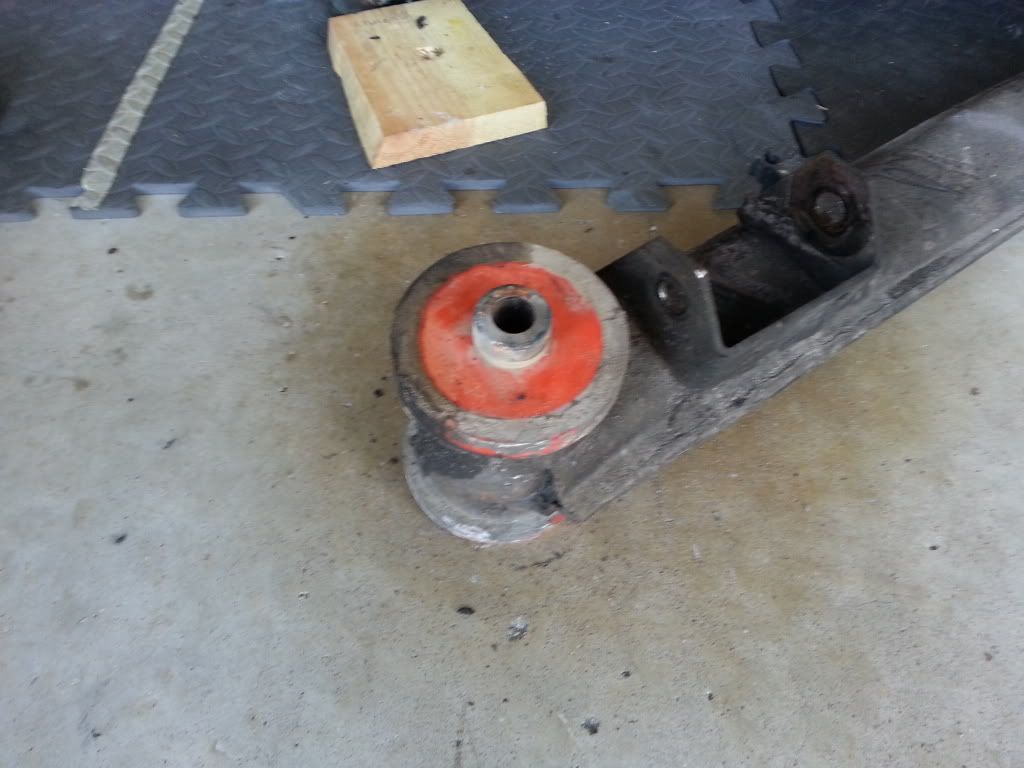

                    Poly bushings in the old subframe. Really want these out intact. Gotta figure it out.
                    Bushing comparison. The ones that the new subframe came with are definitely not usable.
                    If we can sort out the bushing swapping, and my trailing arm ends up not being bent then the car should be on the ground ready for an alignment tomorrow.
