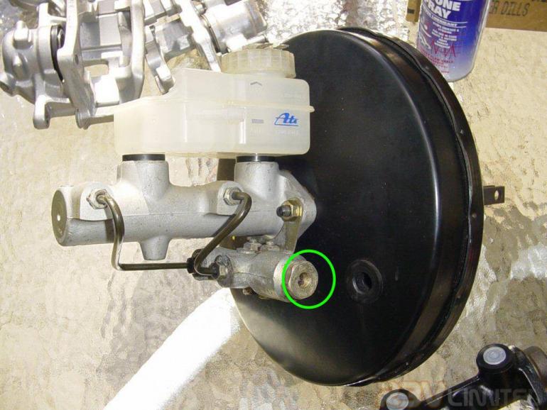

                              Hi, Opposite problem, I'm trying to use an e90 booster in my 87' that HAS ABS, and I seem to have only one line running into my master cylinder's setup, its like connected to iteslf in 2 places (see pic)....
                              This is a stock pic i found on the internet but it shows clearly the setup i have in my car, the 2 lines from the main master go to like a "secondary"? master and there is only one line connected to it where the green circle is.....
                              How do I properly connect my e90 booster if I do not want to remove my ABS......is it even possible? Click image for larger version
