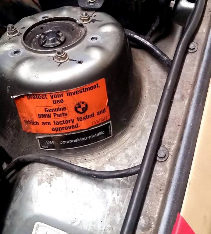

    I found this picture off a thread and was wondering if anyone has tried this and if it actually fixes camber. My driver side is off about -1.5 degrees and I'm willing to do anything that fixes it without spending money.

      It will work, but it's hardly the proper way to do it. You might have clearance issues with the spring on the inside of the strut tower.
      What is causing your car to be off 1.5ยบ? If it's only on one side, something is bent and you need to replace parts or get the frame straightened. Simply moving the mounting point of the strut isn't going to solve the problem completely. It's highly unlikely only the camber is affected if there is frame damage.

            It's a cheap idea but if it works, it works. Anyone that has actually done this?

              Honestly, it doesn't seem like a terrible alternative to buying camber plates, but like others said, if its only one side, there is another problem that should be dealt with.

                The hardest part would be drilling the holes accurately enough as to not change the caster. "Eyeballing" it wouldn't be good enough.

                    Your camber will probably be worse than what you have now by doing something like that...

                      put away the drill bit and break out the piggy bank - there are camber plates out there that aren't that expensive. toe out is a bigger cause of inside tire wear than negative camber anyway. on that note, get an alignment. your camber is probably caused by something bent that needs replaced.

                          Haters gonna hate. Same outcome as these but save $140...

                            140$ I do this same for 50 :D
                            For 150$ I have new CNC control arm's and I can do camber and caster what you want to have.
                            If someone want to know how it look: https://www.facebook.com/Projects.SA...homepage_panel
                            At first time in my own e30 some 10 year's ago i drill new hole's like in photo, and it work.
                            If someone want I can send hole's pattern to print at home and drill new hole's on his own e30. FOR FREE :D

                              Well, I used a huge straight edge to aid my eyeballing it (also judged the amount of clearance between spring and strut tower to limit the offset) but did change the caster some side-to-side. My buddy thought it would pull slightly but handled just fine...
                              Maybe a printed out template would be better for redneckineering as SAS Parts suggested.
                              Oh well, worked fine for the purpose and increased negative camber and alleviated the tire wear issues for $0 cost. Might not do that to a street e30 worth more than $500, but oh well, it can be done.
