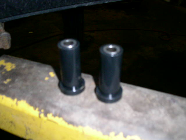

              Hey guys.. DONT WORRY ABOUT THE RUST. the only reason i didnt' take care of it is because some guy wanted to use the lift right after me, so i didnt have the luxury to spend a whole day sanding and painting, but I WILL re-disassemble (which wont be too hard bc i already did it once... everything is kinda loosened up) everything and paint. it will look 100% better when i'm done with the car. Probably sometime in may/june it should all be done.Then i could put my sway bar kit in too...
              They were a bitch to get out and i was pounding on it with the chisel hammer for about 30 minutes to get it loose. I think that the aluminum sleeve and the steel stud make some kind of bond or something bc those fuckers were stuck on!. Thank god i never have to do it again!
              The subframe bushings are $100 from bimmerworld.com and are powerflex
              The trailing arm bushings weren't so hard. I have a pic of them too here..
              The tool is just a 2 jaw puller that I luckily got to clip on the welds of hte trailing arms.. I got really lucky bc i couldnt' pound those out no matter how hard i tried...
