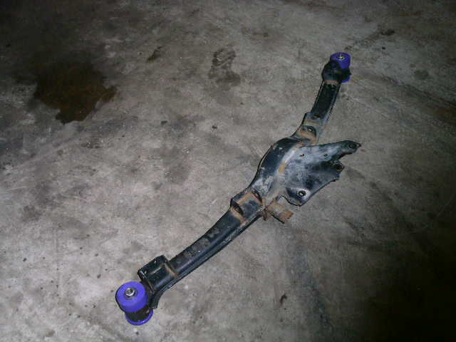

    Some pics from today of my E30. Here's what i did all day today. took appx 10 hours.. i did 90% of it myself,
    Change subframe bushings to urethane bushings,
    change all trailing arm bushings to urethane

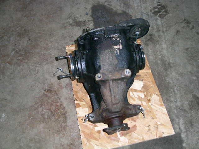

    swap 2.93 diff to 3.73 LSD diff

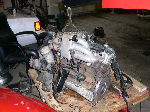

    I also took a shot of my M30 engine that i'm putting in in a couple days...
    That's about it.. ALOT easier said than done!
    any questions about how i did it, let me know

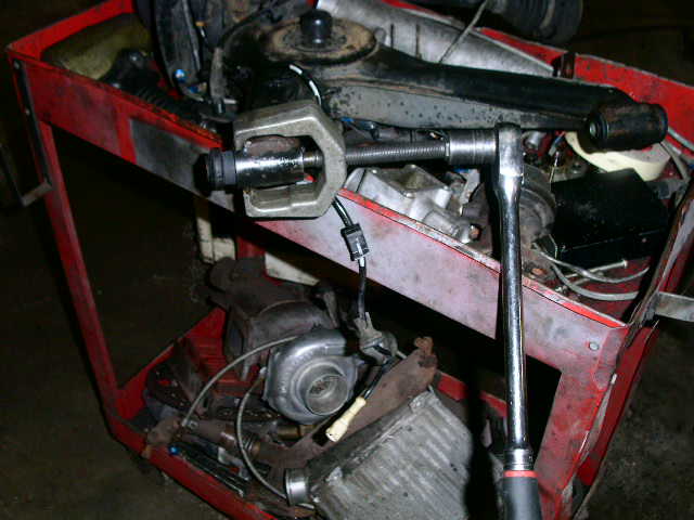

    Did you make that tool?

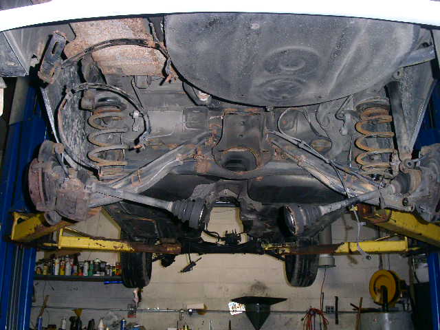

      your car is rusty, that makes it harder. I'm glad mine doesn't look like that underneath!

        Hahaha, i know it's rusty, that doesn't bother me too much though
        I modified the puller for the trailing arms by putting it in a vice and closing the arms just enough to fit over the end of the welds on the trailing arms. Then used a bolt through the sleeve. and pushed the bolt through with the screw puller you see...once i figured that out, it was soooo simple to take the rest of it out..
        As far as the subframe bushings..... still a bitch and a half to take out.. Hopefully i'll never have to do it again..

          if i saw that much rust on my car id be bothered

            You shouldn't leave your driveaxles hanging like that.

                Who makes those subframe bushings? I know IE's are green and red so who makes those?
                '88 325ic
                • Ray Smoodiver
                  • Jun 2004
                  • 8809
                  powerflex

                    Sand the rusty parts and spray it with Zero-rust or rustoleum. Makes it look 100% better and gives you some protection. Especially parts like the fuel tank, if they are rusting.

                      Thats nothing for a NE area car, you guys dont even know what rust is.

                              whats all that brown stuff under your car?!?!?
