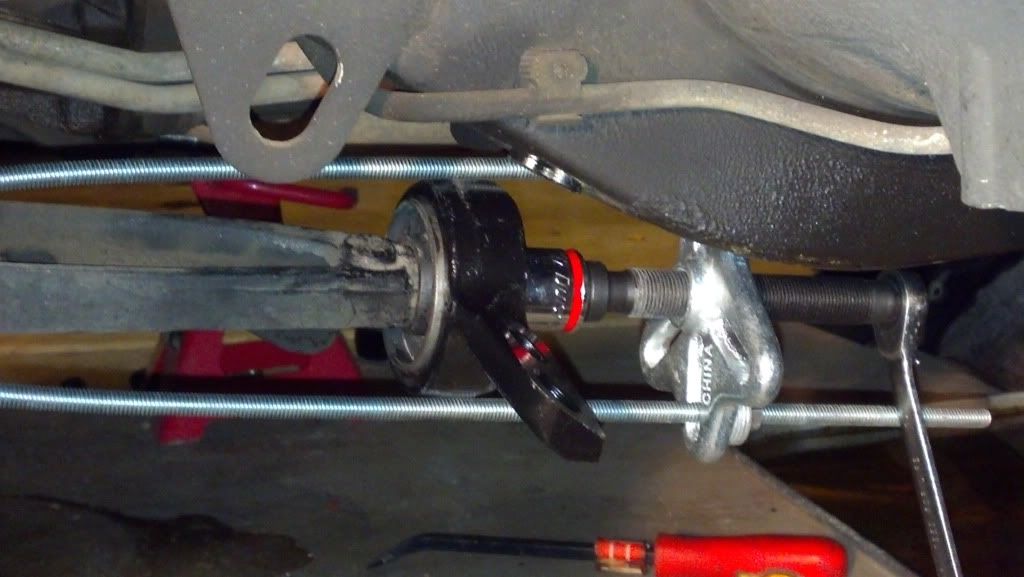

                    • AwakenNoMore
                      • Dec 2010
                      • 1291
                      Threaded rod from Home deport and some nuts/washers, a socket and a cheap steering wheel puller=makeshift press for a few bucks. Bought new control arm bushings already mounted in lollipops. Easy as pie.
                          A cheap 2 jaw puller is all you need. It's probably cheaper than buying a steering wheel puller and threaded rod. Certainly more compact when in place under the car.
