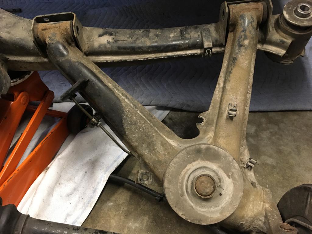

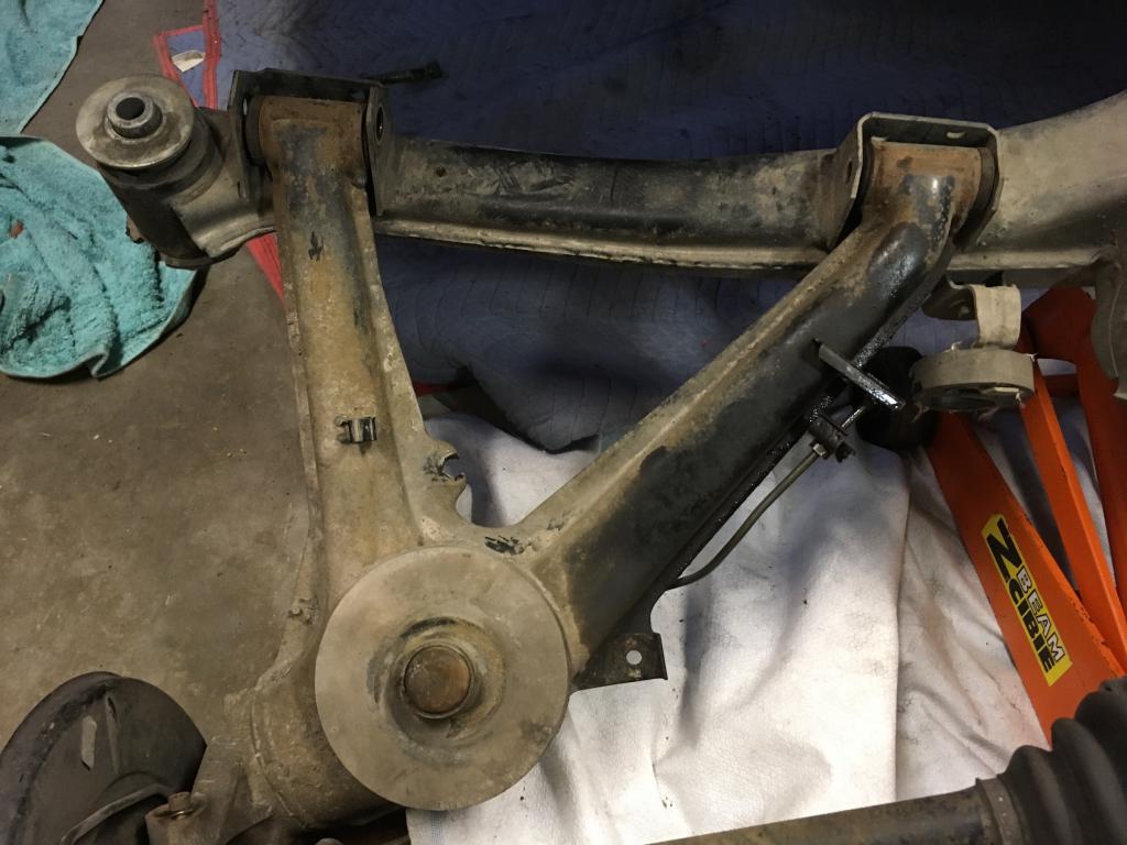

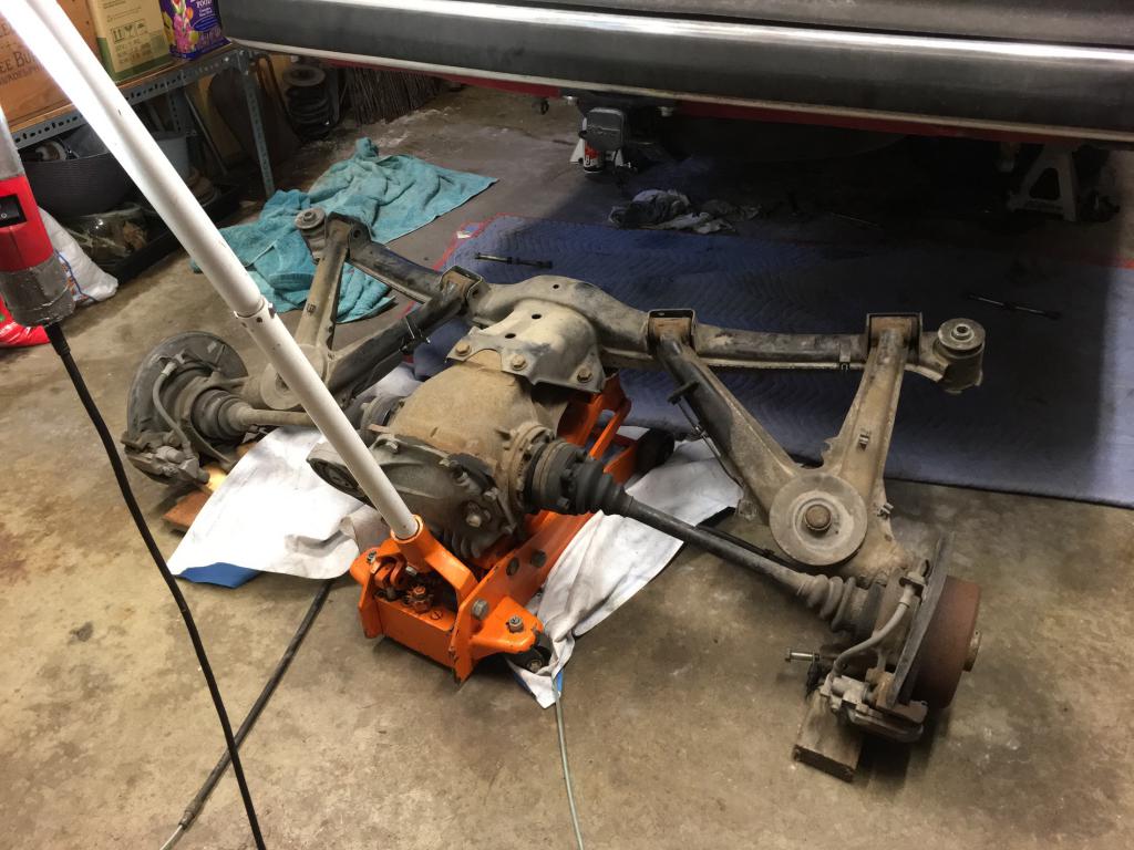

      In the IE directions, early on they say to center the adjustable tab opening on the existing hole CL. Later down the page they say to put all of the adjustment hole towards the direction you want to correct, i.e. less negative camber, increase toe-IN. That gives you the entire 2.5 degrees of correction available, rather than half. What did you do there?
      Are you saying the inboard / camber tabs sat too high and you couldn't center it on the existing hole? Although, if it's higher, that gives you more negative camber reduction as the trailing arm slides up.
      Good heads up on checking fit against the chassis - things are tight in there where you're wrestling that mess around balanced on the jack, trying to get the big subframe mounts past the fenderwell and the front end over the driveshaft!
      No new bushings, just did that. No corrosion, all came apart fairly easily with two people. (Unless you undo the side sill allen bolts before you tap out the big subframe studs and they bind up!)
      Then somebody...not naming names... put the brake line fittings together with gorilla torks, and I trashed the right one getting it loose, even with the right brake line wrench. I'll replace the hard pipe - hope they're available.

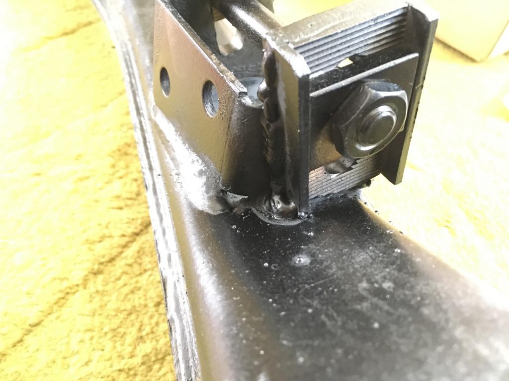

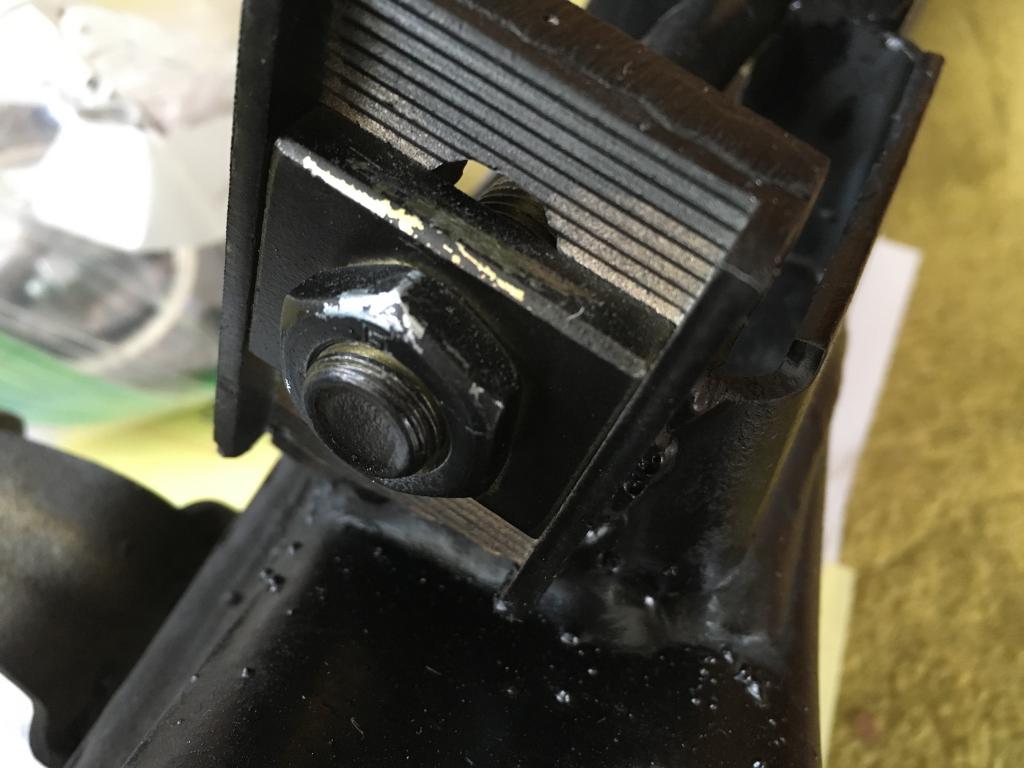

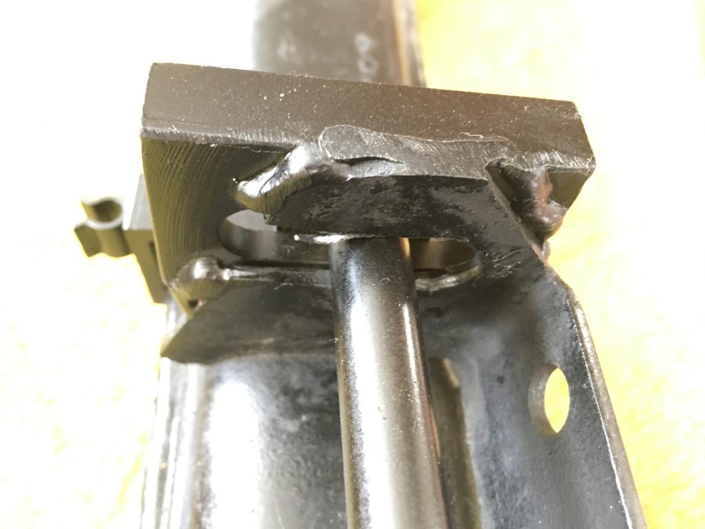

                          • LateFan
                            • May 2013
                            • 4414
                            Here's how mine turned out so far....

                            • dynoclimb
                              • Nov 2011
                              • 88
                              Looks good. the one thing we learned when aligning it was that .070 limit of the groove interval obviously limited our increment of adjustment and then the pivoting ratios of the mounts... So you get really fine adjustments in Camber and the opposite in Toe...
                              Although we're talking small amounts. We got it all close enough that I can't tell...
