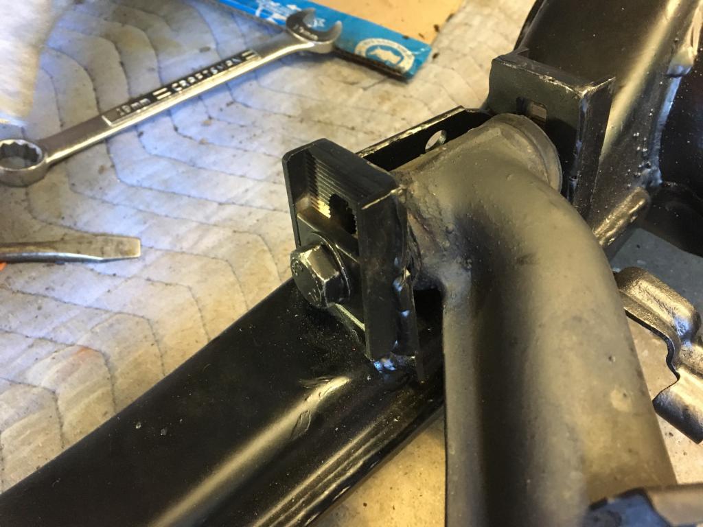

    Is that nut welded on?
    Is there any correlation between what each notch means for degrees of camber?
    Those give a HUGE amount of adjustment compared to the eccentric bolts, almost too much.
    Looks good!

      I wondered about that, how big the jump is from tooth to tooth. The shop that welded it does alignments, so I think I'll have them do it. It's not a restored Duesenberg y'know, but they seem to like our project and let us bring it in.

        Hoveringguy -
        No, small nut is the jamb nut. he just sprayed the whole thing black so it didn't flash rust. It's skinny so you can get a wrench in there to get it off and adjust.
        Dynoclimb above has more info on the adjustment increments. I thought IE said you have 1.5ยบ range either direction if you centered the tab on the existing TA holes.

          Yeah, we made a spreadsheet, that I can't find, that we used to calculate the adjustments.
          Used a String alignment rig, caliper's(measure),and a digital angle gauge.
          Tracks straight and everything is within the BMW Spec window. its nice not to have massive amounts of rear camber now...

            Why does it need a jam nut? I'd be tempted to just tack that nut on.
            The eccentric bolt adjusters just have a nut on the other side, with the serrated plate on this one already being threaded it amounts to the same thing.
            I like the idea of NOT needing a wrench on the other (difficult) side...

              yeah, but vibrations and heat cycles could loosen the bolt to serrated plate threads, So the Jam nut is used to tension that threaded connection to keep it together. I would have preferred to safety wire the bolt head, and think I may look of a drilled bolt to replace it in the future.

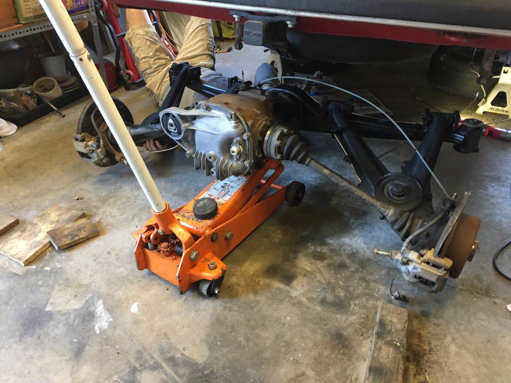

                School's out, time to get this thing back together! So fun to see him fixing his own car.

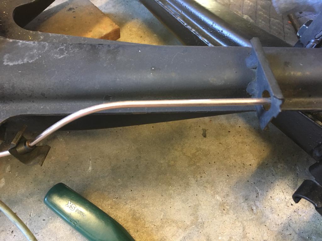

                Cunifer brake pipes. So pretty until you actually maneuver them into place and connect fittings, then you get some wobbly bows here and there - and they're factory length.

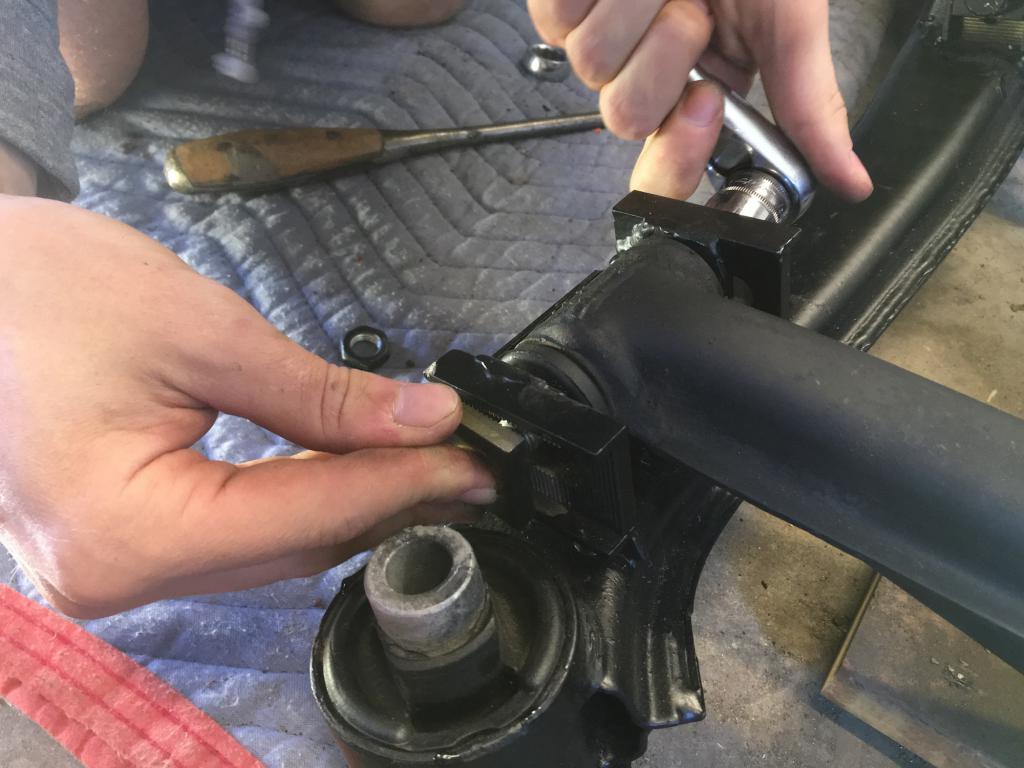

                We set them pretty close to the center of the slots and didn't torque them down hard. We'll take it to the shop that did the welding to align and set it up. IE sent us the missing lock nuts.

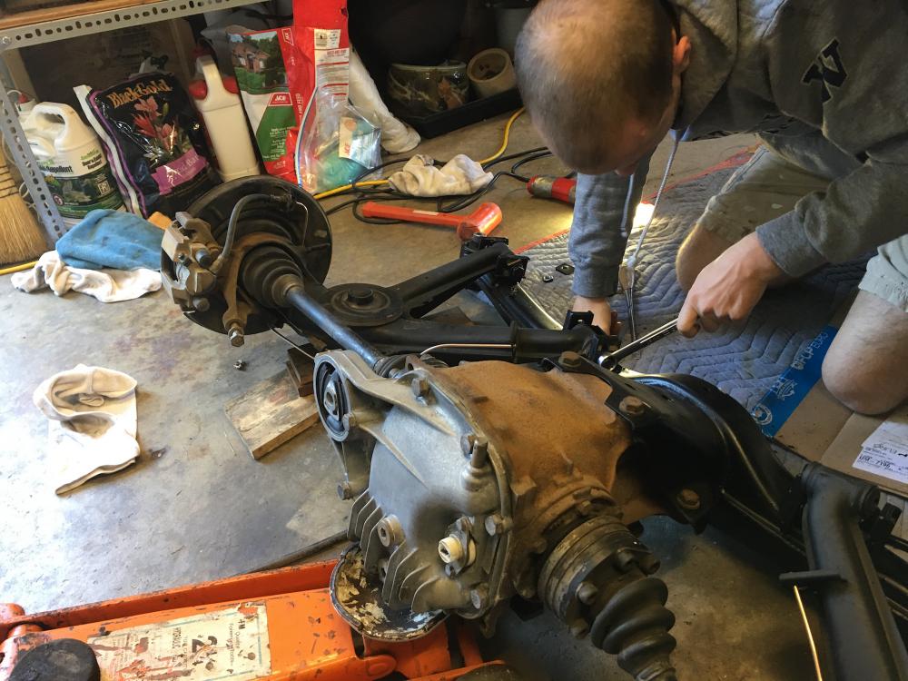

                SO much easier job with two people!

                      Eccentric style adjusters use locking nuts (either nylock or deformed thread style) so there is no need for a jam nut.
                      The serrated style adjusters are just regular threaded on one side, so no locking feature. The jam nut keeps the bolt from unthreading from the serrated plate. You don't need 2 wrenches at the same time, only one on the bolt to tighten, then again on the opposite side for the jam nut.
