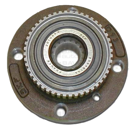

                      Why not? - just because, that's why!
                      There's no reason that the fronts can't be replaced other than that's the way BMW and the aftermarket sells them. The setup is the same as the rear which is also a sealed bearing and is replaced as a bearing only. From this pic it appears that that the bearing has an SKF part number - possibly it could be purchased by itself. It may be that BMW does this for liability reasons as the ABS ring is part of the assembly and the press work is important. Still it's the same basic setup as most other manufacturers.

                        I agree with Josh, the price differance is negliable and when factoring in time and possible problems caused by not doing it right imho it is penny wise and pound foolish.
